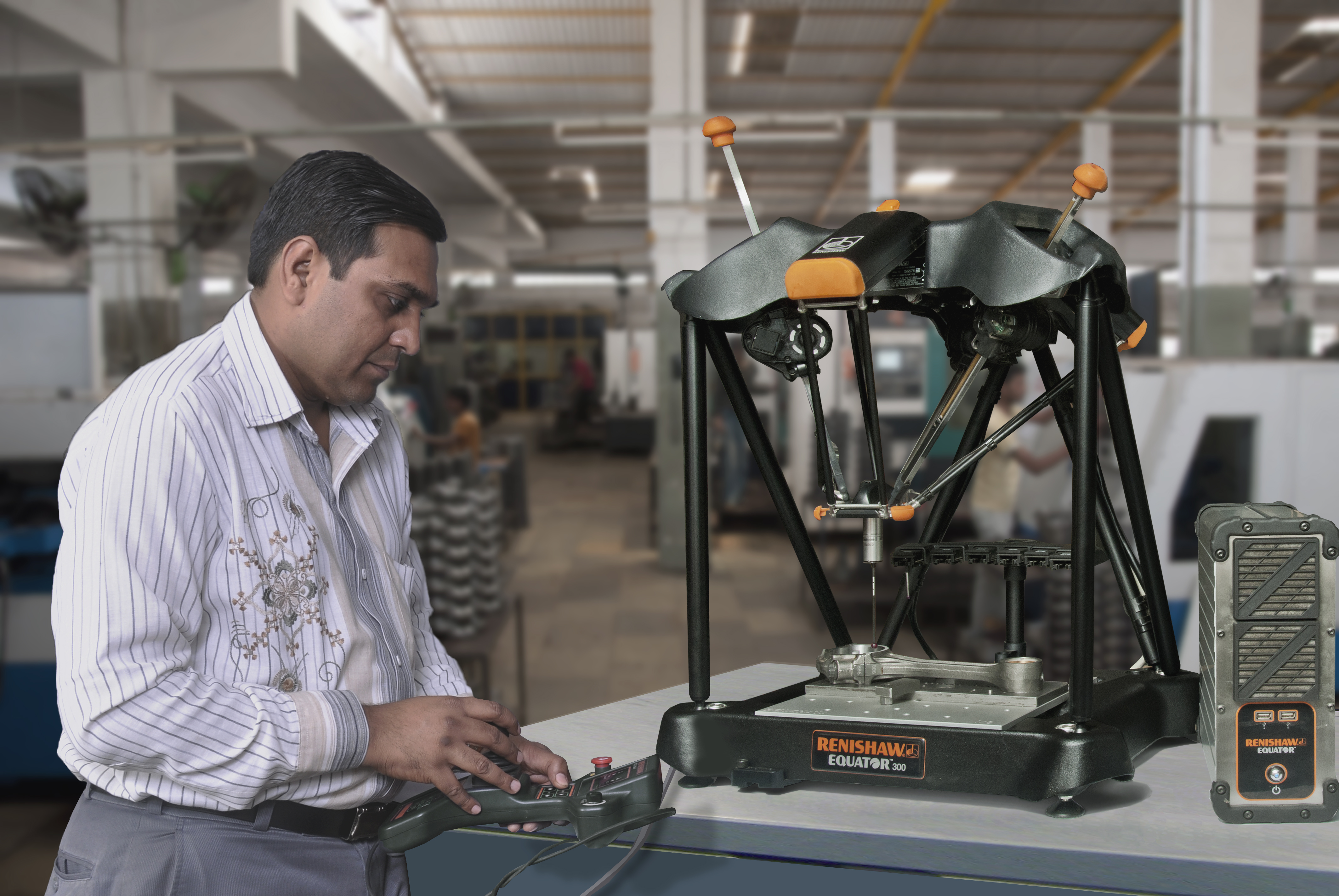

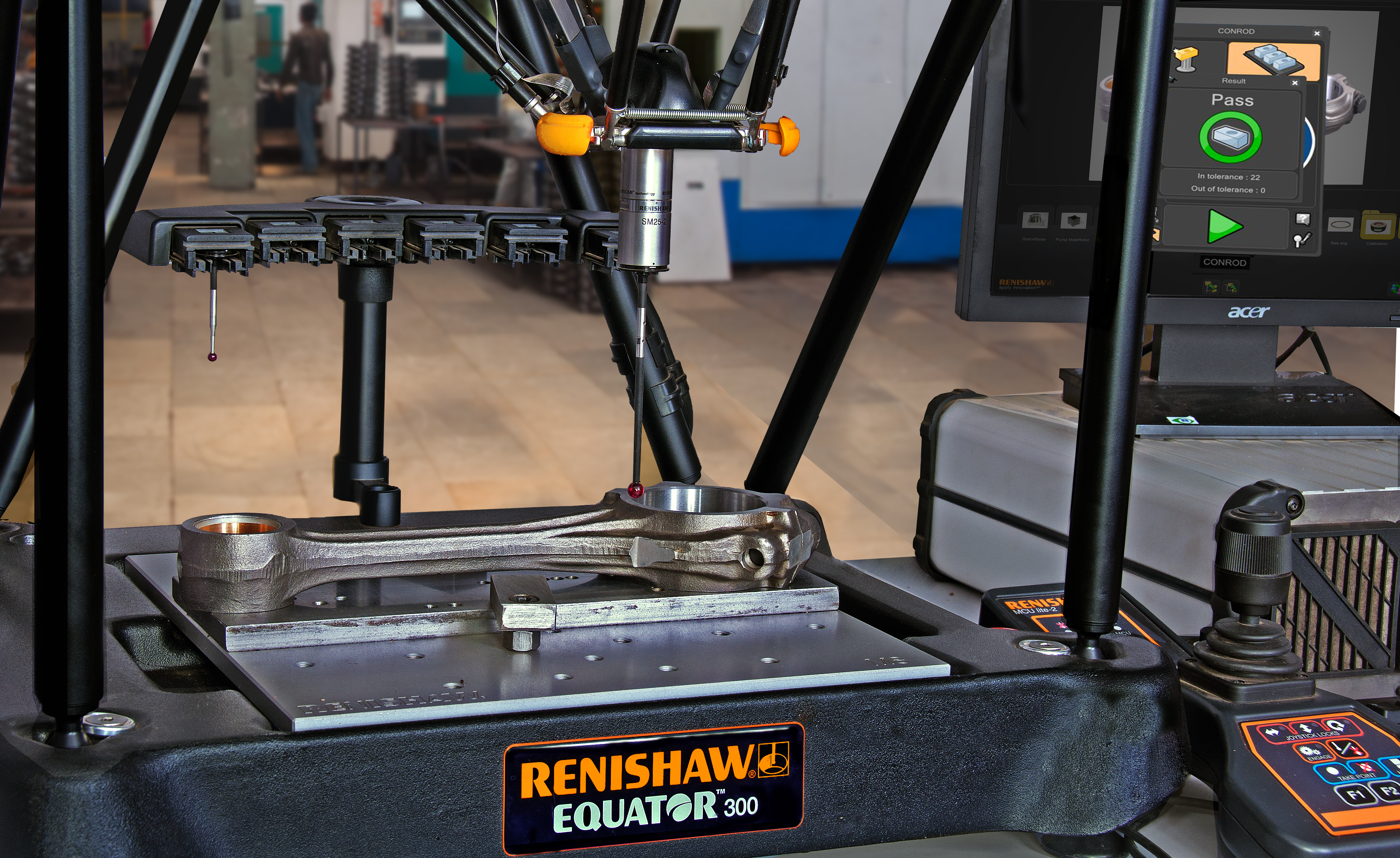

Kishan Auto is now using Equator to gauge multiple variants of connecting rods, and is adding more every day. Typical gauging times of 55 seconds per connecting rod are a significant reduction over previous methods. The operators can use one Equator machine for many different parts, gauging all the features in a single operation with an immediate pass/fail decision, along with a report of the component dimensions.
Despite its location in Rajkot, Gujarat, where temperatures soar to 40 °C (104 °F) and drop to 19 °C (66 °F), Kishan is seeing repeatable results from its Equator system. This is achieved by re-mastering at least every 3 hours, or when they know the temperature has changed significantly - ‘re-zeroing' the system removes the effect of thermal growth from the measurements, and therefore guarantees component quality.

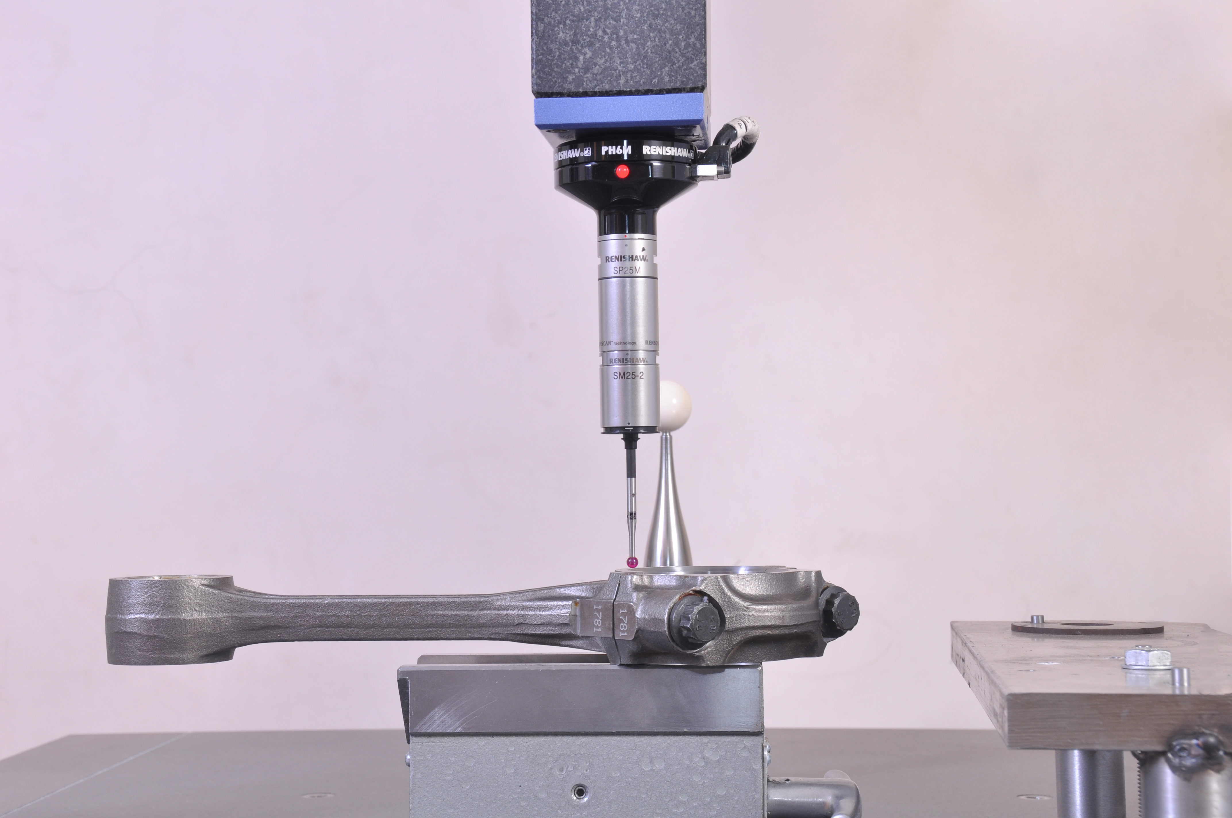

The master parts are ‘calibrated' on Kishan's CMM, which gives them the traceable accuracy they rely on to guarantee quality. However, the high thermal variation means that the CMM has to be used within the company's temperature-controlled room. Equator gives Kishan the opportunity to extend the certified accuracy to the shop floor whatever the conditions. For this particular requirement, Equator has removed the need to purchase an additional CMM with scanning capability, as Mr Shantibhai Changela, Managing Director at Kishan Auto, comments, “Essentially Equator and the CMM complement each other perfectly, one providing the traceable certified accuracy, the other providing the thermal capability and extra capacity.”
