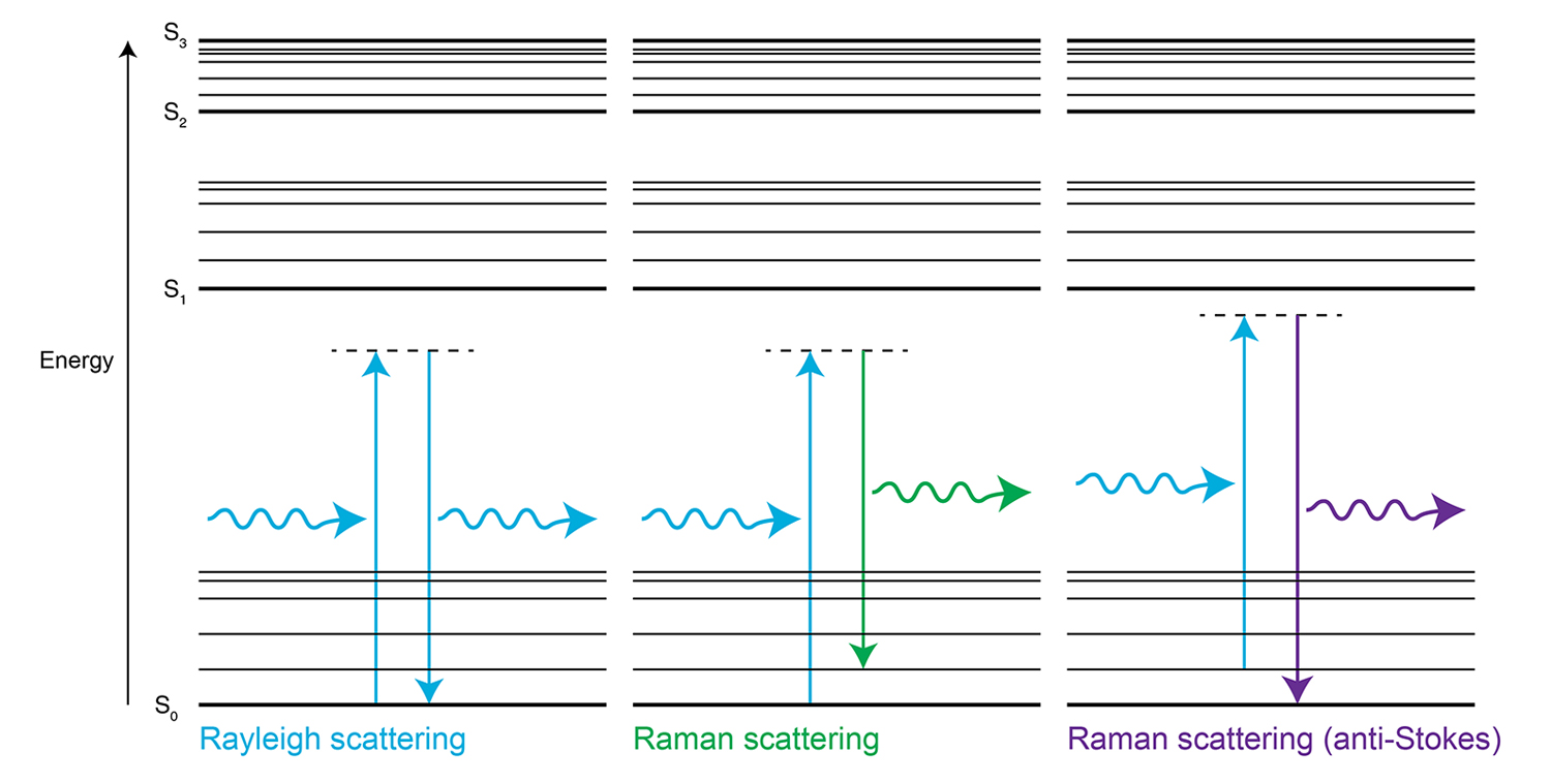

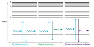

Scattered light
The first step in producing a Raman spectrum is to illuminate your sample with a monochromatic light source, such as a laser.
Most of the light that scatters off is unchanged in energy ('Rayleigh scattered'). A minute fraction—perhaps 1 part in 10 million—has lost or gained energy ('Raman scattered'). This Raman shift occurs because photons (particles of light) exchange part of their energy with molecular vibrations in the material.
Where energy is lost the Raman scattering is designated as 'Stokes'; where energy is gained the Raman scattering is designated as 'anti-Stokes'. We rarely use anti-Stokes Raman light as it is less intense than the Stokes, however it does represent equivalent vibrational information of the molecule.
