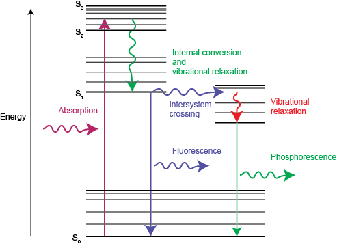

When a sample is illuminated by a laser, both Raman scattering and photoluminescence (PL) can occur. The latter can be many times stronger than the former and can prevent successful Raman analysis.
PL comprises both fluorescence and phosphorescence processes and originates from an absorption/emission process between different electronic energy levels in the material. The amount and type of PL depends on which material you are studying and which laser wavelength you are using. Unwanted fluorescence interference can normally be avoided by choosing an appropriate laser wavelength.

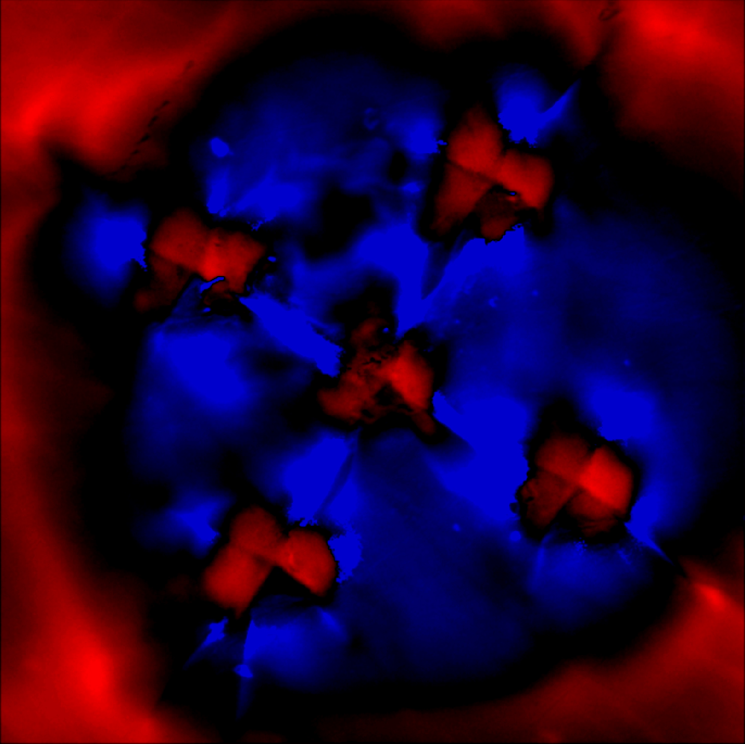

You can also use PL to study crystal defects, such as atomic vacancies and substitutions. This is of particular importance for materials such as diamond and silicon carbide (SiC). Not only can you identify the defect, but you can also tell if the crystal has internal stresses.
