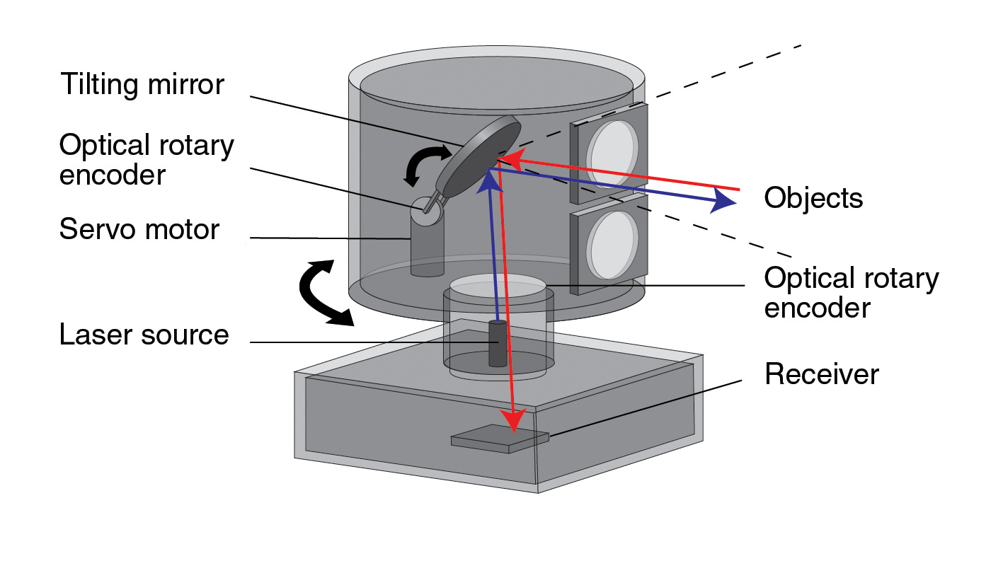

LiDAR optics and encoders
Figure 2: Diagram of the LiDAR optics and encoders
There are two main types of mirror system found in LiDAR scanning systems, either nodding or polygonal-mirror systems. Nodding (tilt) mirrors are the most common, although both types use rotary encoders for closed-loop feedback control of the scan pattern. In most designs, the rotary encoder is mounted on the mirror shaft alongside an electromagnetic motor capable of tilting the mirror clockwise and counter-clockwise about the tilt axis.
The nodding-mirror tilt axis is responsible for the vertical FOV of the instrument (see Figure 2). Panoramic 360° data acquisition is the result of rotating the housing of the LiDAR system about the base. Manufacturers increasingly require that these systems rotate at a high rate of speed, beyond 1000 RPM, to increase the resolution and accuracy of 3D images.
This requires a second motor to rotate the housing about the base in addition to another rotary encoder for precise feedback control. State-of-the-art laser scanners now use arrays of laser diode and photodiode pairs to increase point cloud densities and reduce the number of moving parts. As a result, current systems may employ a single rotary encoder - on the base of the LiDAR system. Encoder accuracy is essential for these applications as angular errors may result in image distortion.
