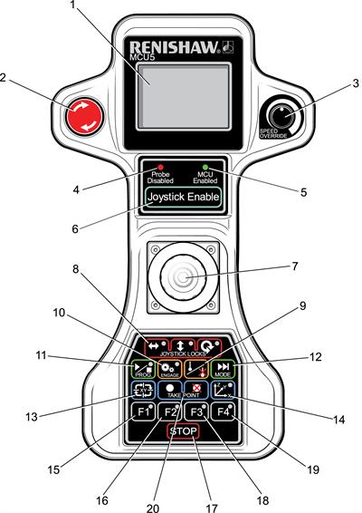

MCU5 legacy hand controller
Compatible with the range of Renishaw CMM controllers and incorporates all the functionality of the HCU1 hand controller for motorised head
- Controls motion of CMM axes
- Indexes the motorised head and rotary table
- Operates as a computer mouse
- Has a system menu for navigating the operating software
- Handheld or table mounted operation
- Large LCD for status information and for interacting with metrology programs
The MCU5 has an additional STOP button on the membrane keypad. This augments the E-STOP and allows a rapid stop of the CMM without disengaging the motors and is recommended for use with the REVO system.
The E-STOP switch has to cut the motor power to all the axes, including the two REVO axes. This is not always appropriate as the REVO A axis will drop to 0° by gravity. Operation of the STOP switch will bring the CMM to a fast stop but the motors will remain engaged in the ‘hold' state.
Key | Description |
1 | LCD screen |
2 | Emergency stop switch |
3 | Speed override |
4 | Probe disabled LED |
5 | MCU enabled LED |
6 | Joystick enable |
7 | 3-axis joystick with push button |
8 | Joystick locks (three separate buttons) |
9 | Probe disabled (see '14') |
10 | Engage servos |
11 | Start / stop program |
12 | Mode change |
13 | Joystick orientation |
14 | Axis systems select |
15 | F1 function |
16 | F2 function |
17 | STOP |
18 | F3 function |
19 | F4 function |
20 | Take point / cancel point |
