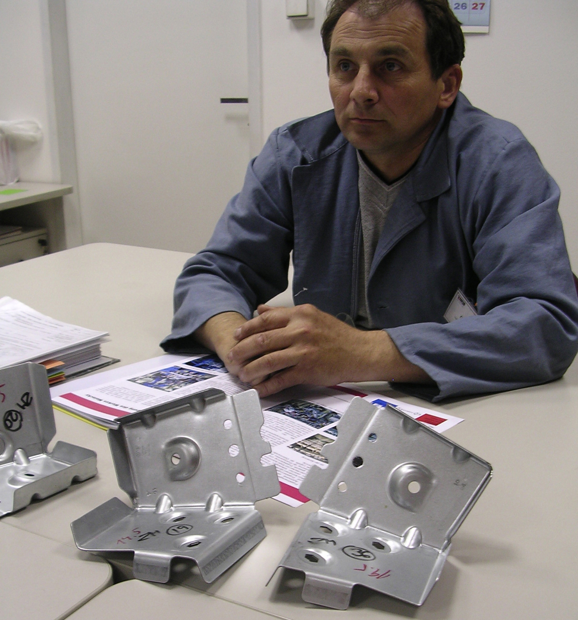

Finished pressed parts and other bought-in items, are all subject to sample inspection, to ensure compliance with the high tolerances demanded by their automotive customers. For each production run, 100% of the features on a sample part are inspected on the CMMs. If this part is within tolerance, then the rest of the batch, usually thousands of parts, will meet specification.
For example, 10 points are taken on a particular flange measuring 70 mm by 20 mm; if any vary from nominal position by more than 0.5 mm the part is rejected and production is halted. Flatness and form are very important, so inspection of features such as corner radiuses must be carefully controlled.
