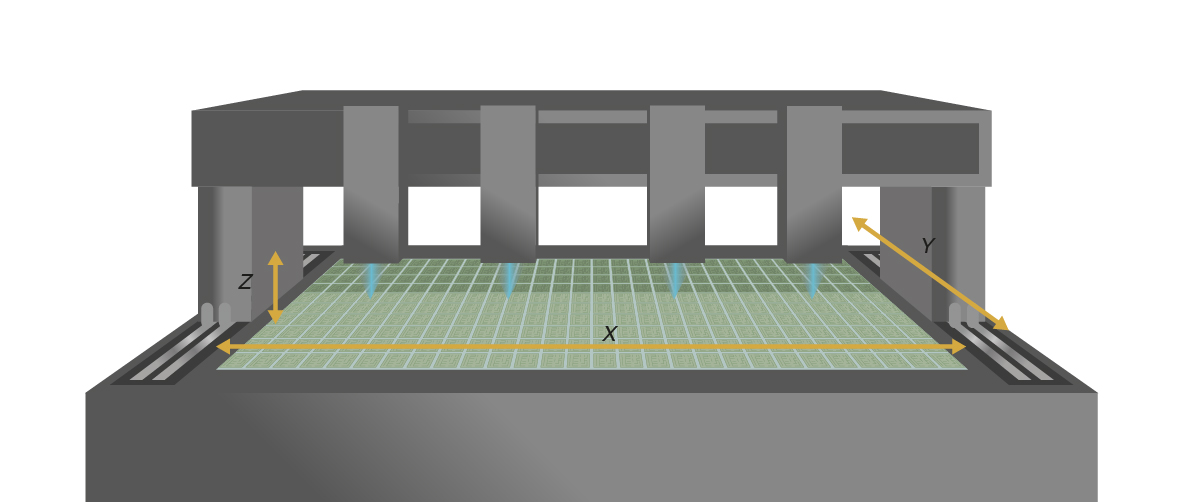

An example parallel-image writer system, shown in Figure 3, includes a parallel array of SLM imaging units, each unit comprising a SLM die, a spherical mirror, multiple illumination sources and a projection lens assembly, as shown in Figure 2. The SLM die is a MEMs (Micro-Electromechanical Systems) device under incident light with thousands of controllable micro-mirrors that tilt to create a high-contrast light and dark mask pattern in the lens focal plane. Precise motion control is needed to coordinate both the imaging unit and the larger substrate motion stage underneath. In this case, the substrate moves along the X-axis and the SLM unit moves along the Y-axis, like a print head. Both stages are supported on air-bearings and are driven by linear motors.
A vision system may be employed to guide the imaging units via reference markers on the substrate stage. This type of system could also be used with roll-to-roll flexible substrates.

In such manufacturing systems, position sensor feedback allows precise control of position in addition to providing data used for linear motor commutation. To give the required alignment accuracy of <±2 microns for FPD, encoder resolutions of significantly less than 1 µm are required. High-performance linear optical encoders and laser interferometers, such as Renishaw's VIONiC and RLE fibre-optic laser encoder ranges, are appropriate for this application.

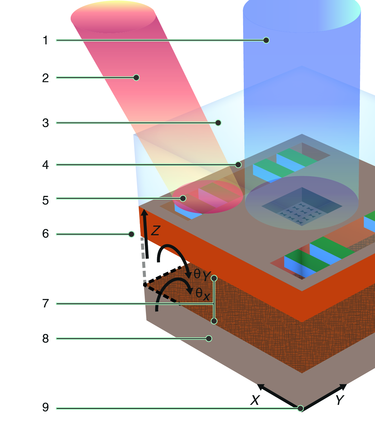

Near-field scanning lithography (NSOL) is particularly promising in these applications as it overcomes the Rayleigh diffraction limit on resolution. NSOL, shown in Figure 4 & 5, scans a probe with nano-sized apertures as ‘diffraction-unlimited' light sources on a mask to direct-write surface features in the optical near-field. The light emerging from these nano-apertures strongly diverges over tens of nanometres and therefore precise control of the gap distance between the mask and the substrate within tens of nanometres is crucial for maintaining process performance.
By addressing each individual aperture in turn with a laser, it is possible to construct an image directly on the substrate. Multi-axis piezoelectric stages are used to position the substrate with respect to the mask. Position encoder feedback for these stages needs to be within the sub-nanometre resolution range and therefore laser interferometer-type systems are preferred for finer adjustments. Conventional high-performance optical encoders can be used for commutation of the coarse linear motor stages.
Near-field scanning lithography device
1 = UV exposure light
2 = Detection laser light
3 = Quartz substrate
4 = Thin metal layer
5 = Metrology gratings
6 = Gap control mechanism
7 = Uniform nanoscale gap
8 = Flat substrate coated with photoresist
9 = Sample scanning motion axes
