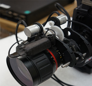

Power Plus' current pan-tilt head models offer resolutions to 1.6M CPR which is sufficient for today's broadcast standard and even 4K TV when upgraded. Power Plus has also developed motorised devices, for controlling the focus and zoom rings on the camera head, which utilise magnetic encoders supplied by RLS, an associate company of Renishaw from Slovenia. The RLS RE22 series rotary magnetic encoder is designed to be compact and offers resolutions of 13-bits for high speed operation to 20,000 RPM.
Mr Wong says: “The device consists of two individual gear modules coupled to the focus and zoom rings on the camera, each module is equipped with the RE22 encoder system to transfer positional data to the virtual studio system during zooming and focusing. The RE 22 offers a simple integration with our existing camera head models but more important is its cost-effective performance and the confidence delivered.” He concludes: “Thanks go to Renishaw. They always provide the best support and an excellent delivery service. Presently, we have some new projects which involve TONiC™ and RESOLUTE™ absolute encoders. With Renishaw's support, we are confident about developing more innovative and successful products for the broadcasting industry in the future.”
