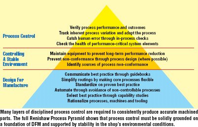

Renishaw calls this fundamental methodology the Renishaw Productivity System. Whereas RAMTIC can be seen as an example of process control applied at the machine level, the larger Renishaw Productivity System can be seen as the essential foundation that makes process control possible and effective on a factory-wide basis. Stonehouse demonstrates that with an intelligent strategy and a strong commitment, any manufacturer should be able to keep production on its own turf.

Pyramid Of Power
A visitor to the shop floor at Stonehouse could be easily dazzled by its open, tidy appearance and wowed by a closer look at its machining efficiencies. However, what s visible is only part of the story. Perhaps more impressive (and equally important) are the unseen engineering principles that, layer by layer, build up a foundation for the process control in place at the machines. These are graphically summarized in the pyramid below.
A few comments about design for manufacturing (DFM) and maintaining a stable shop environment will suffice to sketch out this larger picture. DFM has truly come into its own since Stonehouse opened. The old machine shop at New Mills is now devoted to proving out part production and to developing new machining processes. Each machine at New Mills duplicates one in each class of machines at Stonehouse—identical machines in identical conditions. Here, the manufacturing engineer can develop, verify and document every aspect of a new part process, from cost analysis, fixture design and CNC programming to tooling selection, trial runs and capability studies. Likewise, processes that are not covered in the DFM guidelines (now disseminated electronically across the company’s intranet) are tested here before being added to the library.
By the time a new part is released for production, all of the manufacturing problems have been addressed. As Gareth Hankins (right), GM of Renishaw’s Manufacturing Services Division, points out, DFM is the best opportunity for achieving production economies because most of the decisions that affect part cost are made during the design phase.
Thus, it’s not surprising that most of Renishaw’s manufacturing engineers are now focused on DFM. Only a third is involved in the support of operations currently running in production. It used to be the other way around. A similar shift in focus has occurred in the duties of shop floor personnel.
Their main responsibilities now lie in the middle section of the productivity pyramid. Most shopfloor activities revolve around maintaining a stable operating environment rather than tending the machining processes. These highly automated systems essentially run themselves, but they cannot achieve consistently predictable results unless sources of variation are constantly kept under control. Establishing standard, best practices and following them rigorously is the key. An example is the “pre-flight checklist” that machine operators must tick off, sign and have a supervisor review. The list ensures that appropriate checks and day-to-day maintenance tasks are completed before a day’s production can begin.
