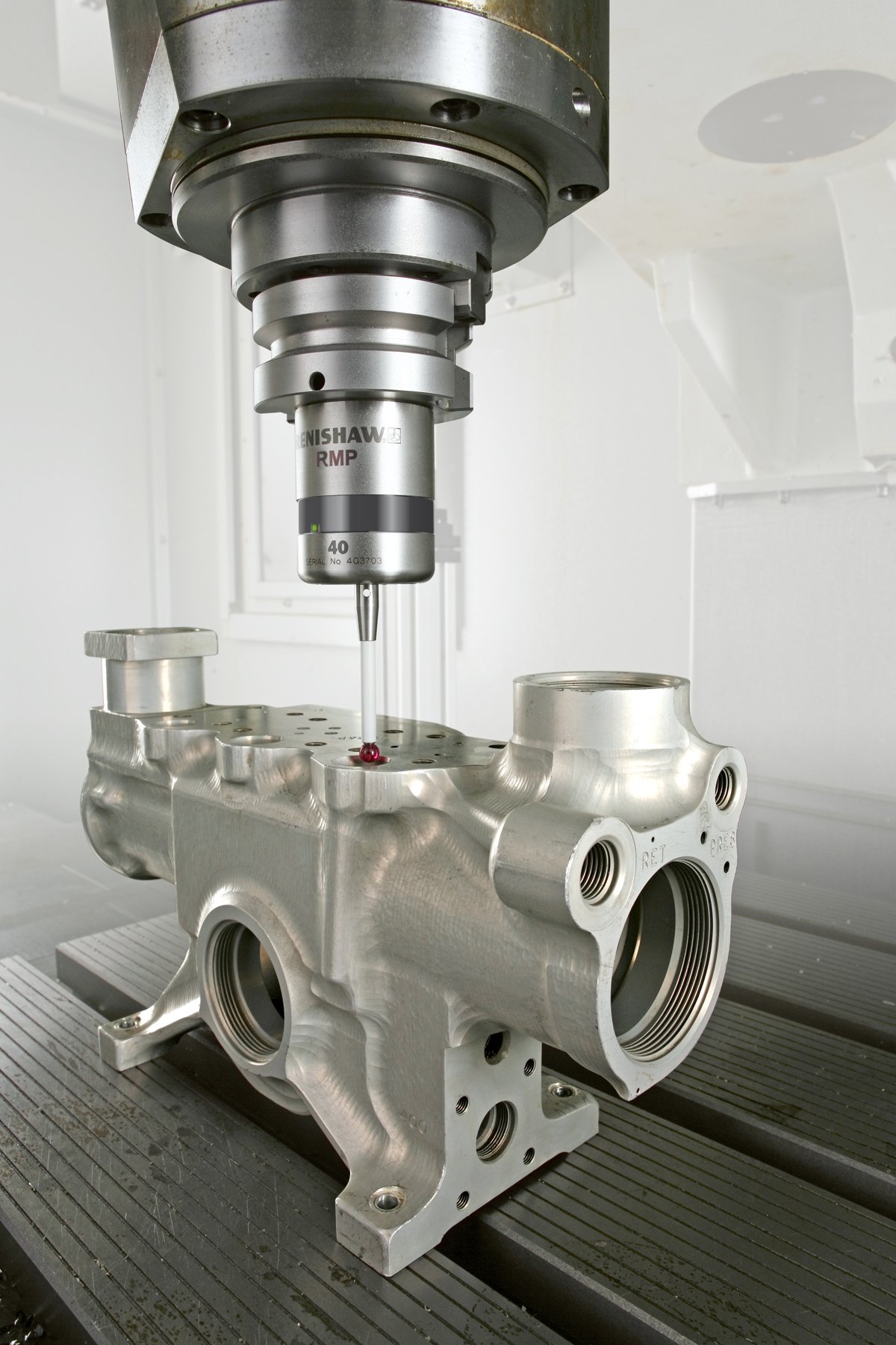

Renishaw will make waves at WESTEC with the introduction of new touch probe systems that use its unique frequency hopping spread spectrum (FHSS) probe signal radio transmission technology to allow automated job set-up and in-process measurement on all sizes of CNC machine tools. The new ultra-compact RMP40 touch probe (image right) is especially suited to multi-axis and mill-turn applications, whilst its variant, the RLP40 touch probe, is specifically designed for more hostile turning environments.

RMP40 radio probe
Image - RMP40 ultra-compact touch probe with radio signal transmission 1200x1800px
