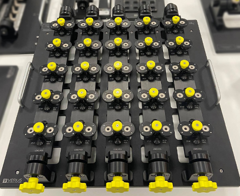

A bespoke Verus 48-station fixture for measuring soft rubber components
One of Verus Metrology’s fixturing designs holding tubes and caps for inspection on the Equator™ 300 gauging system
One of Verus Metrology's fixturing designs holding tubes and caps for inspection on the Equator 300 gauging system

Michael continued, “The working volume of the Equator 300 gave us the start point. Our solution would need to fit within the Equator 300 gauge's working volume of 300 mm diameter and 150 mm height. When you know that a gauging system like Equator can perform very fast inspection routines, then the challenge quickly becomes: how can we get the most out of it? Inspecting single components one-by-one, even using some kind of shuttle system to load and unload, was just too slow and cumbersome. Given the relatively small size of each of the two components, we determined early on that multi-station fixturing was perfectly viable and would give us the means to achieve the increased speed objective.”
Working in hard anodised aluminium and medical grade plastic, Verus Metrology Partners designed and manufactured a bespoke 8-station fixture for each different component. This repeatedly presents tubes and caps into fixed positions within the working envelope, ready for probing.
Michael commented, “The fixturing here plays a critical role. Not only does it need to present the Equator gauge with all the access it needs to inspect the two or five critical dimensions on each component, but it also needs to avoid any deformation of the component. It needs to support robust, repeatable metrology and can't jeopardise the geometry or integrity of the component being measured – be it vial or cap.”

By integrating an Equator 300 gauging system with bespoke multi-station fixturing, Verus Metrology Partners has succeeded in dramatically reducing the batch release times of SiO2 Materials Science's COVID-19 test kit components. Once programmed, the Equator gauge executes the inspection routine at the push of a button. An operator simply loads the vials or caps onto the relevant component fixtures, sets the inspection program running on the Equator gauge and can leave it to inspect eight components at a time.
