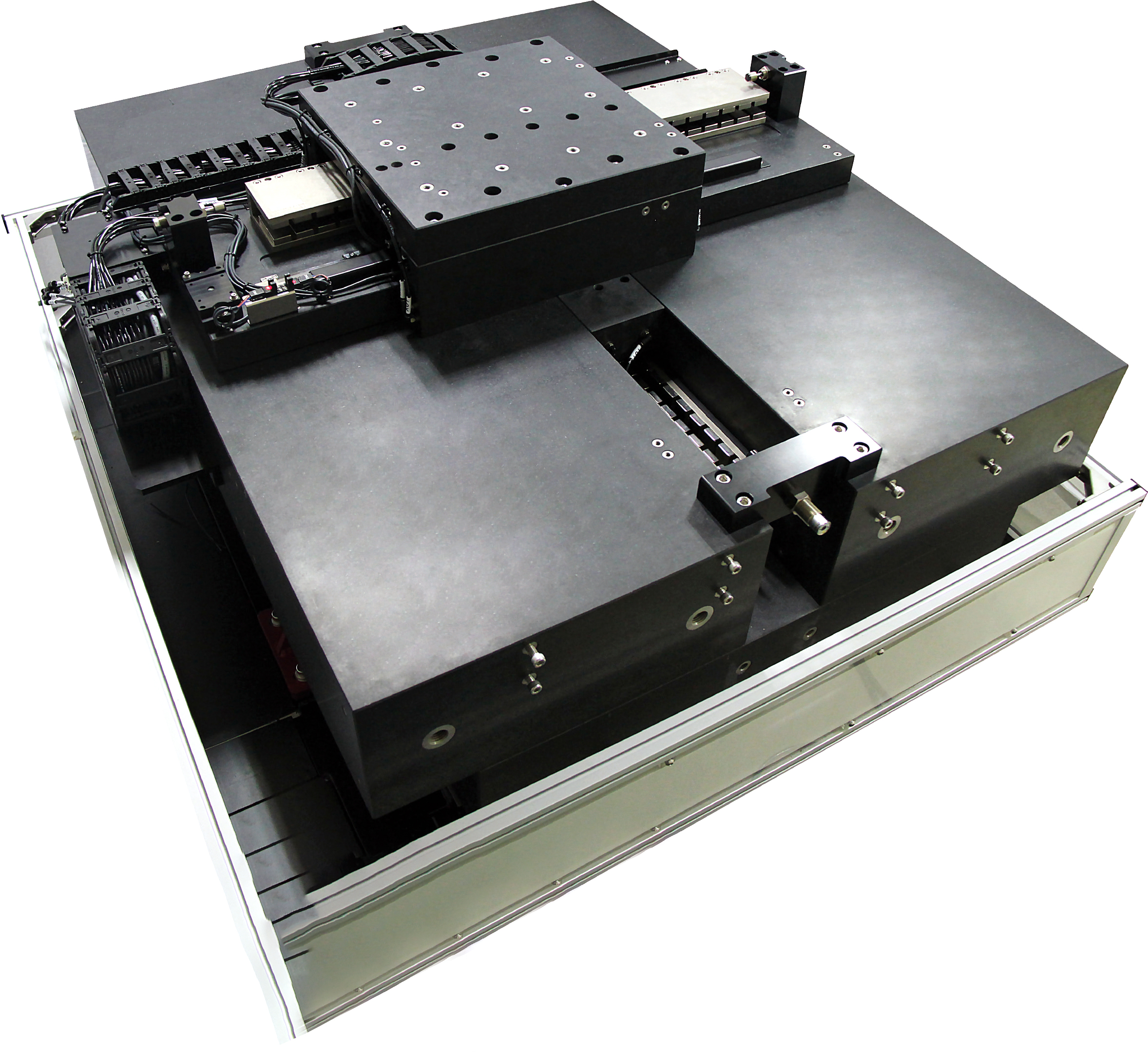

![TOYO air bearing motion stage](/media/img/gen/faf40047f11449dba8bbe1584ebb0ef6.jpg)
Linear XY air bearing stage
