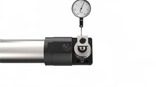

Installation guide: Probe On-centre adjustment [en]
This movie is a guide to Probe On-centre adjustment using a generic Renishaw Machine tool touch probe as part of installation, maintenance or problem solving.

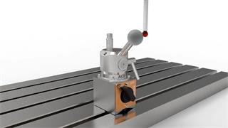

Machine tool probe calibration - Using ACS-1 [en]
How to movie - Machine tool touch probe Calibration using the ACS-1

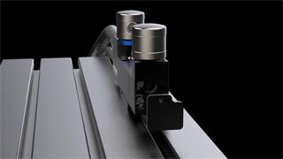

Installation guide: Aligning and Set-up for the NC4 fixed system with a voltmeter [en]
This movie is a guide to the NC4 fixed system alignment and set-up, for help with installation or problem solving.
Installation guide: Aligning the NC4 fixed system to the machine axes [en]
This movie is a guide to NC4 table alignment, for help with installation or problem solving.

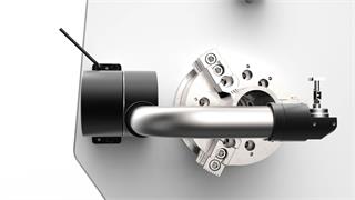

Installation guide: Aligning the stylus on a HPPA or HPMA tool setting arm [en]
This movie is a guide to aligning the stylus on a Renishaw HPPA or HPMA tool setter, as part of installation, maintenance or problem solving.

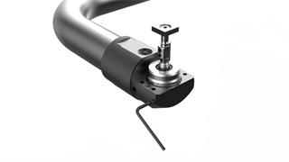

Installation guide: Aligning the stylus on an HPRA tool setting arm [en]
This movie is a guide to aligning the stylus on a Renishaw HPRA tool setter, as part of installation, maintenance or problem solving.

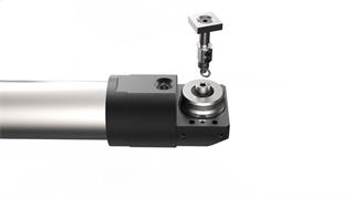

Installation guide: RP3 Probe removal [en]
This movie is a guide to RP3 Probe removal on a Renishaw tool setting arm, as part of installation, maintenance or problem solving.
Installation guide: Cleaning and diaphragm inspection of RP3 [en]
This movie is a guide to cleaning and diaphragm inspection of an RP3 probe on a Renishaw tool setting arm, as part of installation, maintenance or problem solving.
