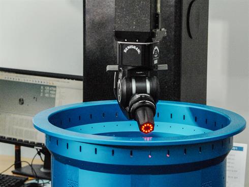

DUKIN use Renishaw's PH20 and REVO® 5-axis probe systems on their CMMs. Robust CMM design is essential to realise the full performance potential of these measurement systems.

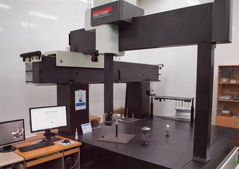

For example, in a CMM bridge design; the X-axis (along the bridge) is driven along two guideways in the Y-axis direction where each shoulder of the bridge is driven by a linear system equipped with a separate servo motor.
Solution
To prevent a torque moment in the Z-axis direction and thereby distortion of the bridge structure, force feed-forward control is applied by the controller. This depends on the detected position of the measurement head as it moves along the X-axis guideway and the setpoint acceleration along the Y-axis.
Alternatively, comparison of the accelerations of the Y-axis guideways may provide additional feedback control of the bridge moment. Dependable, high-accuracy, position encoders are vital for these complex control regimes to work. A combination of a priori data and position and acceleration feedback in the X-, Y- and Z- axis directions are used to give the highest-levels of metrology performance.

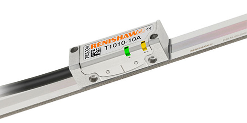

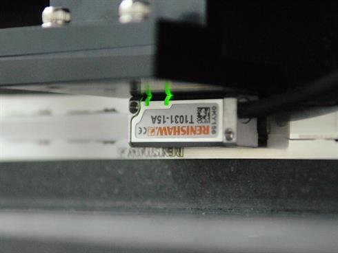

Renishaw encoders and scales are used across the full range of CMMs offered by DUKIN. The TONiC™ incremental encoder system with RTLC linear scale is installed on DUKIN's gantry and bridge-type models. TONiC is Renishaw's compact, non-contact encoder system that offers speeds up to 10 m/s and linear resolutions down to 1 nm for both linear and rotary applications.
RTLC is a low profile stainless steel tape scale featuring a 20 µm pitch. It is accurate to ±5 µm/m and may be ordered in lengths of up to 10 m. Any thermal expansion of RTLC scale is independent of the substrate as it is suspended in a carrier track, which maintains an air gap underneath the scale.
As temperature changes occur in the CMM operating environment, the RTLC scale does not follow the same degree of deformation as the granite base. Thermal compensation is therefore greatly simplified – particularly in temperature controlled environments with the encoder scales and workpiece(s) in thermal equilibrium.
TONiC's dynamic signal processing gives improved signal stability with ultra-low Sub-Divisional Error of typically <±30 nm to help realize superior motion control performance.
