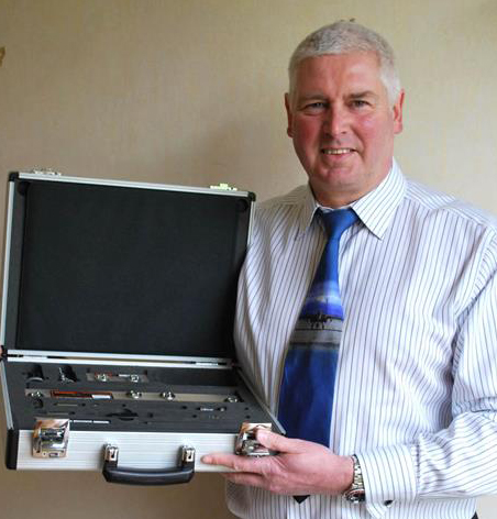

Dave Wigmore, a time-served engineer at Mazak, runs a CNC maintenance service company and considers a ballbar critical to operations. When Renishaw introduced the QC20-W telescoping ballbar system he was determined to be the first UK user.
Dave Wigmore set up his maintenance company, Wigmore CNC, in 1992 so he knows CNC machines inside out. For years he used the Renishaw QC10 ballbar to perform tests of machine performance but there has always been something that he knew could be improved – the wire. "Now I don't have to worry about someone catching the wire and knocking the ballbar off during a test or working out how the wire will wind around. I am much more willing to do a quick test on any machine which I can do with no extra preparation; that small element of hassle has been taken away and the set-up is much faster."
Mr Wigmore, who did indeed receive the first QC20-W ballbar to be supplied in the UK, continues, "I pushed Renishaw to supply me with a QC20-W ballbar as soon as I heard they were intending to launch a wireless version of the QC10 ballbar using Bluetooth® wireless technology. Having used a QC10 ballbar system daily for years, I know it has separated me from other CNC maintenance companies. It is an independent traceable measure of the servicing I have done, critical in the aerospace industry, where I do most of my business.
