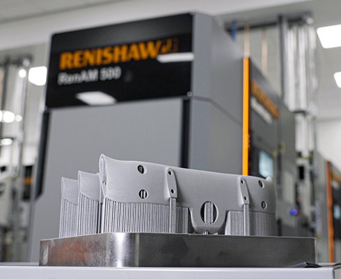

Through British Cycling, Lotus Engineering approached Renishaw during the design for manufacturing phase. Lotus Engineering needed metal additive manufacturing support to improve the bike handlebar performance because this method can build lighter components than traditional manufacturing methods.
Before undertaking this project with the Great Britain Cycling Team, Renishaw already had significant experience in the use of 3D printing for bicycle manufacture. It has worked closely with extreme mountain bike manufacturer, Atherton; produced components for the ARION4 project team that achieved the male and female world record speeds for hand cycling in 2018; and in 2013 produced the world's first metal 3D printed bike frame for mountain bike manufacturer, Empire Cycles, an achievement that was recognised by Guinness World Records.
"Renishaw joined the Olympic track bike project in 2019 and became involved in the design for manufacture stage," explained Ben Collins Design/Development Engineer at Renishaw. "By implementing additive manufacturing (AM) into the design and prototyping stage, our team was able to quickly manufacture the design changes, so the aerodynamic capabilities of the design could be tested. Ensuring the design was light, geometrically correct and strong enough to endure the strain from the riders was a constant balancing act, so many iterations were created to find the ideal balance."
"Additive manufacturing does not require any bespoke tooling, such as casting moulds, which are specific to each job," continued Collins. "During the prototyping stage, we are creating one-off batches, which can be carried out much faster by using AM technology, compared to more traditional casting methods."

Renishaw initially used its AM expertise to rapidly produce plastic and metal prototype parts to undertake aerodynamic testing of the new design and ensure that parts were light, geometrically correct and strong enough to endure the strain from riders. After proof of concept, the company then used its own RenAM 500Q AM systems to additively manufacture aluminium and titanium parts, including handlebars, for the competition bikes, with parts customised for individual athletes.
