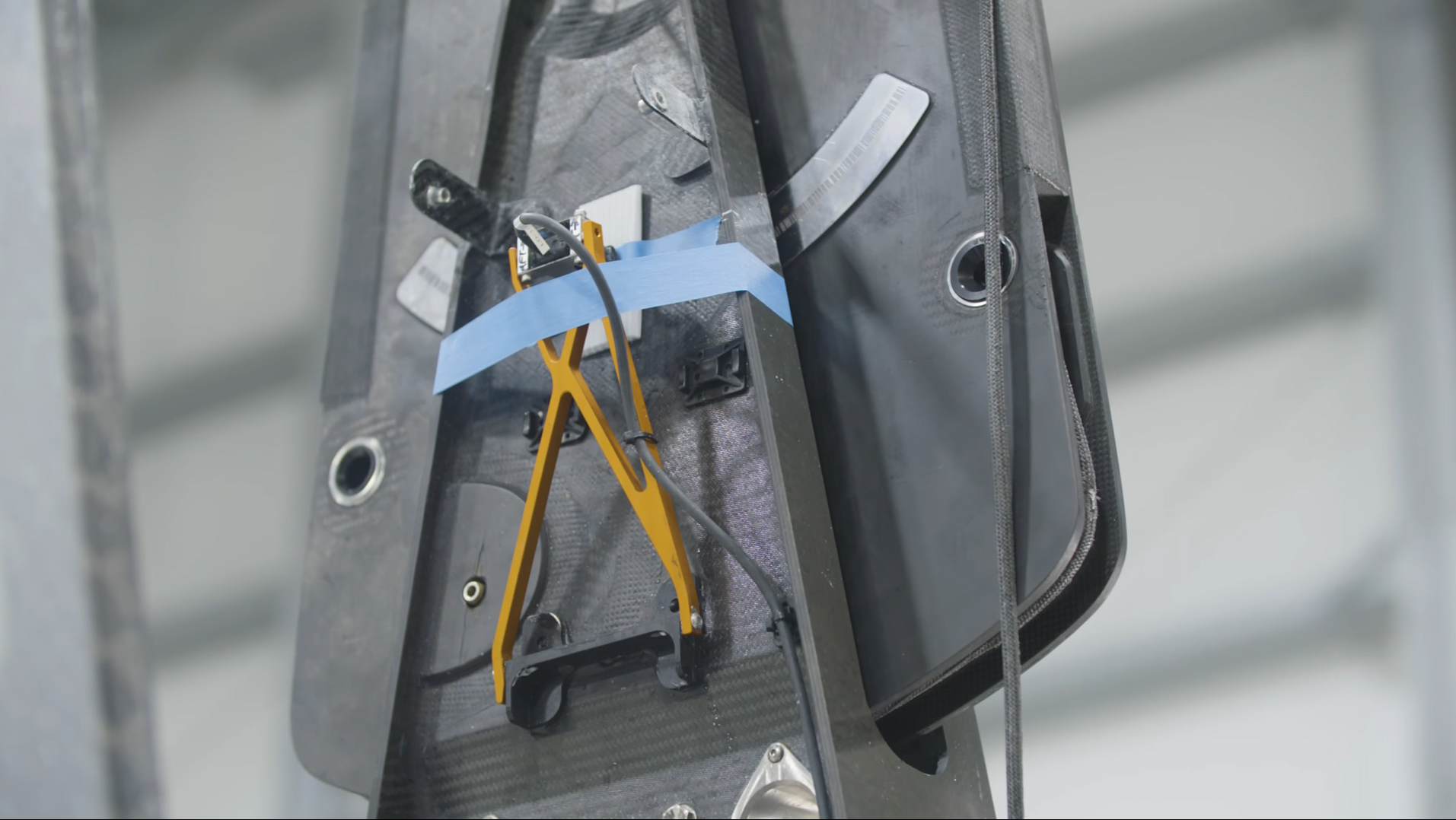

The encoders are on the main wing, and there are four of them: one at the top, two on the main body of the wing and one at the bottom. A fifth encoder is mounted on the hull at the bottom of the mast. The wing encoders measure the wing flap twist from top to bottom and the one on the mast determines the angle-of-attack of the whole wing assembly. In addition to that, there are two down in the hull for measuring the positions of the port and starboard rudders. Now, these boats can go up to 60 mph or so, which creates a lot of high-impact spray. Saltwater conditions and regular contact with seawater wash necessitate robust sealing of the encoder sensor and electronics – particularly for those closest to the water line.
Could you describe how the flaps on the wing-sail work?
A traditional sail is a curved sheet of material with a mast that the air flows around. The wing is much more like the aerofoil of an aeroplane where you have a flap that pivots in either direction depending on the wind angle relative to your intended direction. To actuate these flaps, there are three main ones, flap control plates called hammerheads are pulled left and right by internal control lines. As far as the encoder goes, a partial-arc scale is mounted on the moving flap part whereas the sensor head is mounted within the wing rib. Down at the rudder, we've taken the same technology – the same building blocks – that we've created and used a similar arrangement.

The encoders installed on a hammerhead (flap control plate)

Understanding Land Rover BAR's requirements was the most important aspect, but given the time restriction, we had to select technology from building blocks that we already had from pre-existing commercial encoders. Space and geometry requirements in the wing were significant factors in determining the design. Each part was a real challenge; we started with a module that exists for a linear encoder for use on a precision plated shaft with carefully shaped grooves embedded under the surface. We had to effectively unwrap that code and embed it into a flat surface with differently shaped grooves along an arc using a new process and hope that the resulting flat arc equivalent scale would work first time.
We took the pre-existing LinACE™ module from our RLS associate company, and repackaged it into a waterproof encapsulation, which we hadn't done before, to allow it to survive the operating environment. This also provided an encoder body which was small enough to operate within the tight dimensional constraints of the highly stressed wing ribs. We also had to come up with a solution that allowed the scale part to twist and move but without inducing significant errors when the sensor moved.
What was your solution?
We had to come up with a gimbal arrangement for the sensor whereby the partial-arc scale can twist out of its plane of rotation without inducing inaccuracy. A special aluminium wishbone and yoke assembly was designed to hold the readhead with high precision while allowing for pitch and roll. The wishbone is attached to the wing's static structure. This whole encoder assembly gives a much more accurate reading of the position of each flap than inferring from actuator movements.
