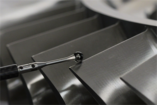

![OPTiMUM diamond styli scanning an aerospace blisk workpiece](/media/img/gen/bfb1f40e44e042f68a707f6e6e1dd518.png)
Renishaw has developed OPTiMUM™ diamond styli to support the increasing need for high-speed scanning applications. Discover how diamond-coated spheres maintain their roundness and do not suffer material ‘build-up' or premature wear when scanning a part.
