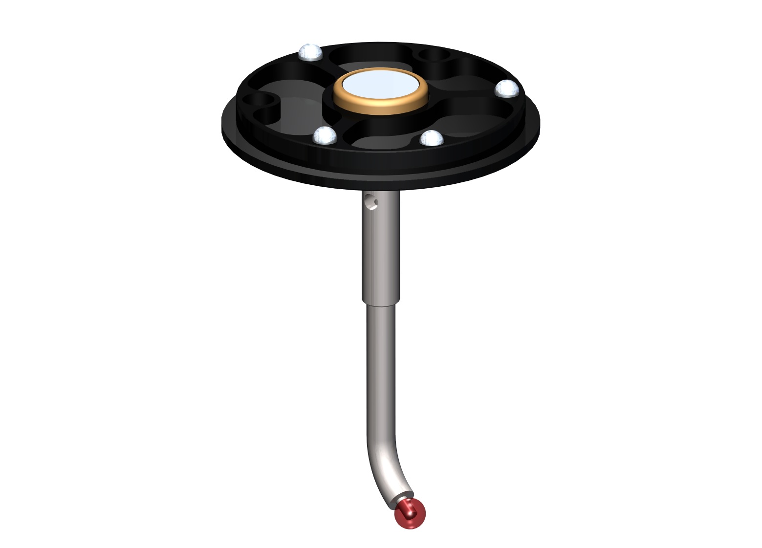

Additively manufactured styli
![Application image: AM curved REVO stylus](/media/img/gen/609fad1b9e9543b9ae43d1f5e80c2d18.jpg)
Metal additive manufacturing (AM) is a flexible and powerful technology. It allows us to create components and parts that cannot be made using traditional manufacturing methods.
These can include complex shapes with internal structures and latticework that are both light and strong, enabling repeatable metrology.
The high degree of flexibility in design means additively manufactured styli can be created and customised for almost any application. Custom styli for metrology applications provide more measurement options than ever before.
All additively manufactured styli are designed and produced in house by Renishaw, ensuring short lead times and high standards of quality.
Let us design and 3D print an additively manufactured stylus for you.
