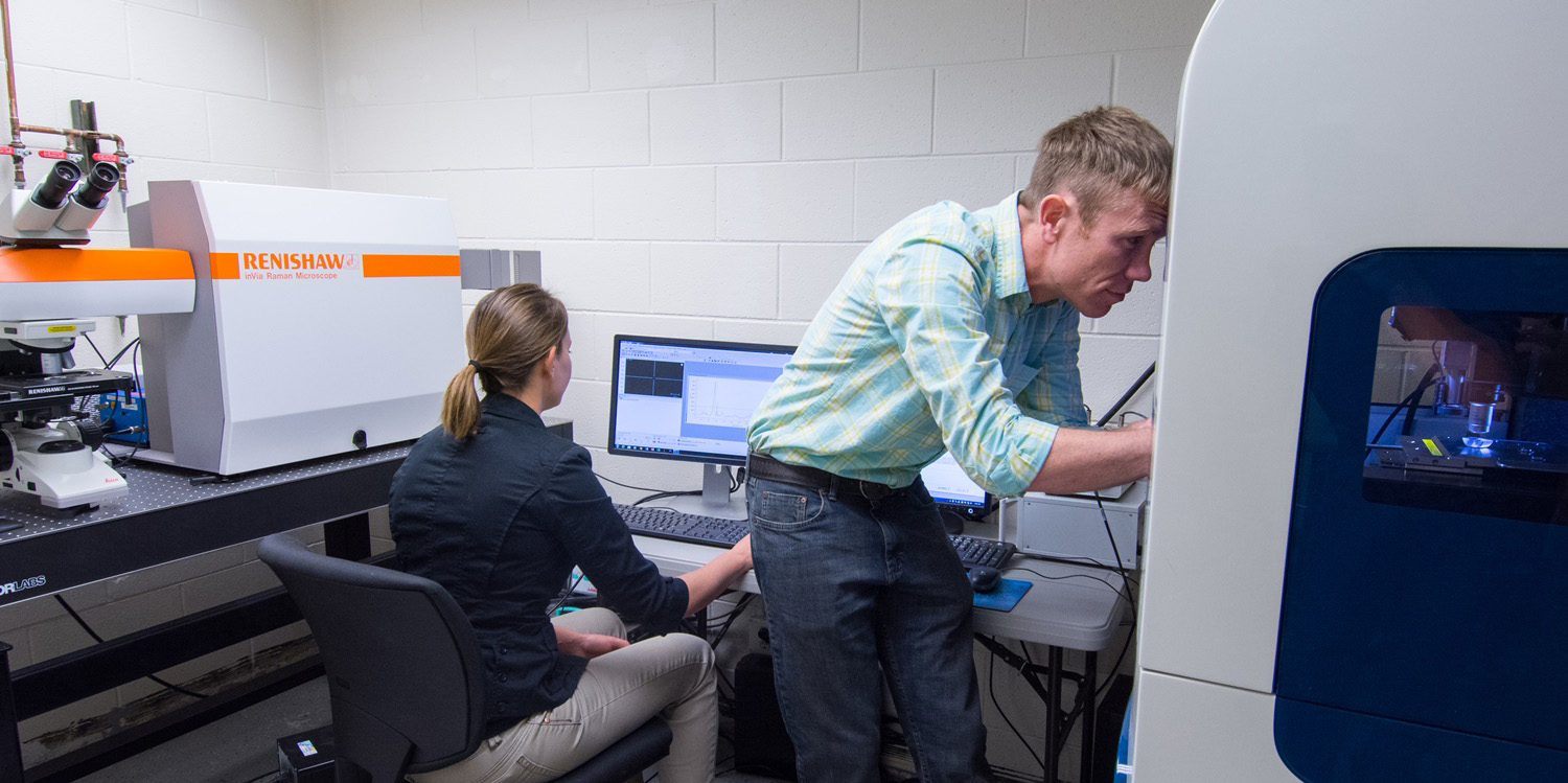

The Biomechanics and Biomimetics Research Laboratory at the University of Colorado Boulder uses a Renishaw inVia™ confocal Raman microscope to characterise biological tissues and biomaterials. The system has been interfaced with a nanoindenter system from Hysitron Inc, Minneapolis, USA, to provide combined chemical and mechanical information on samples.

Pairing Renishaw's inVia Raman microscope with the nanoindenter from Hysitron results in a combined instrument that provides a greatly enhanced characterisation capability, complementing existing spectroscopies. Professor Ferguson said, “This unique system provides the capability to investigate mechanical properties and mechanical behaviours in parallel with imaging the chemical constituents within the materials being tested at exactly matched sites / locations with ~1 µm resolution. We use the information on a material's chemistry to elucidate changes in mechanical properties or to explain mechanical properties within single sites or when mapping over 2D regions. Moreover, mapping reveals gradients or heterogeneity of material chemistry and crystal structure. We can also uniquely evaluate chemical changes that occur following pressure induced phase transformations (that could be applied by nanoindentation, for example).”
Professor Ferguson continued, “The inVia offers a degree of customization that is not available on other systems. More importantly, we like the manner in which the inVia collects Raman spectra compared to other systems. We are the first to have joined the Hysitron nanoindenter with any Raman spectroscopy tool and have had technical challenges to overcome. I have been exceptionally pleased with the level of customer support we have received from Renishaw during the development of our unique combined instrument. Renishaw has been fantastic to work with.”
