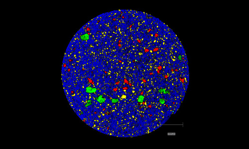

Image gallery
  • Polished igneous rock section from Tibet
  • Streamline image of human oesophagus
  • Crystal domains in a polycrystalline photovoltaic cell
  • StreamLine Raman image showing inhaler active pharmaceutical ingredients
  • StreamLine Raman image of tablet used for the treatment of Parkinson’s disease
  • Raman image of washing powder
