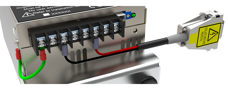

The output cable is to be attached to the terminals as shown below and torqued to 1 Nm.

WARNING: Output terminal cover must be re-fitted after termination.
WARNING: Do not remove output earth connection marked with this label:
WARNING: The PSU must be connected to a protective earth.
The output voltage of this power supply can be adjusted between 41 V and 56 V, For best performance, this should be set to match the maximum CMM motor voltage.
NOTE: Do not use excessive force whilst adjusting the PSU output voltage control.
