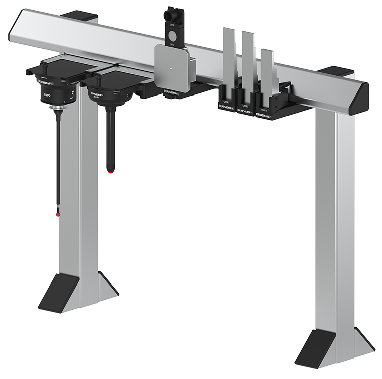

The REVO-2 probe change system is designed to allow automatic REVO-2 probe and accessory changing on a CMM. For optimum metrology, RUP1 should be changed automatically using REVO-2 change port (RCP TC-3). These ports are mounted on the modular rack system (MRS or MRS2).
RUP in rack with RSP2
RCP TC-3
The RCP TC-3 is a thermally controlled port for changing RSP3-6, SFP2 and RUP1 probes.
