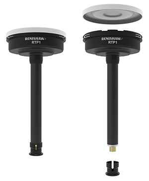

  • Remove protective caps prior to use:
RTP1 with caps removed
  • Avoid dropping the RTP1 or colliding with workpieces or parts of the CMM structure
  • Particular care should be given to the two ends of the probe (the mating face to the REVO head and the temperature sensor)
  • Ensure measurement surfaces are dry and clear of debris before being inspected with RTP1
