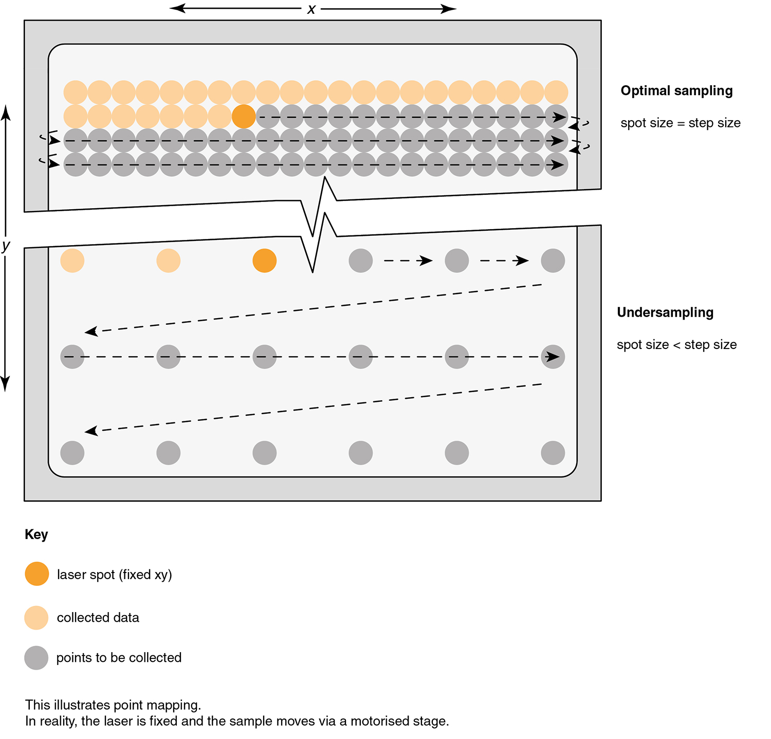

Undersampling
The relationship between the spot size and step size is a crucial aspect of sampling.
Optimal sampling occurs when these are equal. The whole area is covered without overlapping.
Undersampling occurs when the step size is greater than the laser spot size. This makes mapping faster but there are regions of our sample that have not been analysed.

Undersampling is the fastest way of analysing a large area but you can miss small, important features.
Slalom zigzags StreamLine's laser line, ensuring that the whole of the surface is sampled while maintaining short experiment times. This provides an effective solution to the problem of undersampling.
