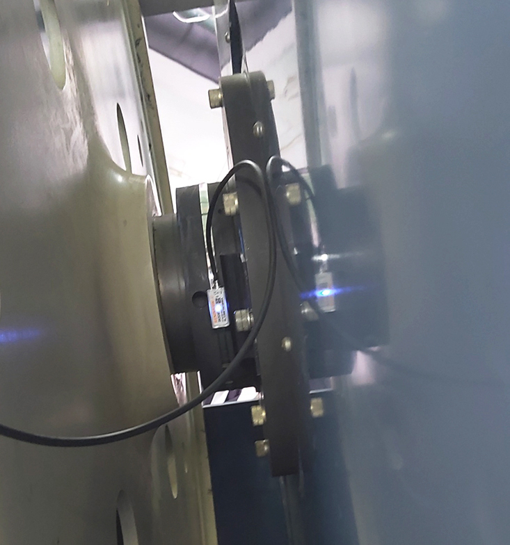

RESOLUTE encoder readhead in-situ on the roll axis of the telescope

The Soulutions team suggested installing two Renishaw RESOLUTE™ absolute encoders onto the telescope. The RESOLUTE series is the world's first absolute encoder capable of 1 nm resolution up to 100 m/s for linear systems, and 32-bit resolution up to 36,000 rev/min for rotary systems. Ultra-low Sub-Divisional Error (SDE) and jitter result in a linear encoder system that outperforms any other encoder in its class.
The team chose encoders with RTLA30-S linear scale, a low-profile stainless steel tape scale that has mounting options that allow for thermal expansion and the convenience of tape scale. This technology offers unrivalled ruggedness, excellent motion control performance, wide set-up tolerances, improved positional stability and ±40 nm Sub-Divisional Error for smooth velocity control.
“During our first visit to the observatory we decided that we could not remove the original encoders from the telescope, because it would require us to disassemble the entire telescope, increasing downtime for the research team,” said Mr. Naim.
“Instead, we suggested disconnecting the original encoders and attaching the new encoders using bespoke manufactured mechanical brackets, allowing us to complete the project quickly and efficiently.”
The team installed the linear encoders to each axis of the telescope during two visits to site. The roll axis controls the orientation of the telescope, which is used to view different areas of sky, while the pan axis controls the side-to-side movement of the lens and camera.
"Renishaw's Advanced Diagnostic Tool (ADTa-100) allowed us to test the technology before connecting it to the telescope's controller," said Mr. Naim.
“We used the software to confirm that both encoders give good feedback, to check the signal strength across the full axis movement and to ensure good motion control. Once we knew the installation was successful, we connected the system to the controller.”
Renishaw's ADTa-100 acquires comprehensive real-time data from Renishaw's RESOLUTE absolute encoders and displays this information via the user-friendly ADT View software interface. This tool can be used to report on encoder performance in challenging installations or assist in system fault-finding to avoid lengthy machine downtime.
