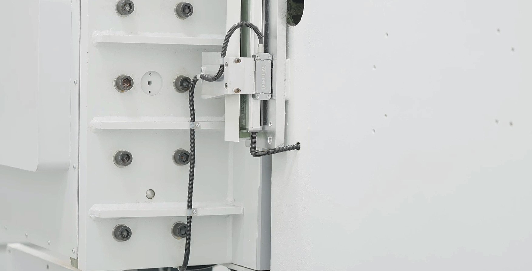

Effective CNC chose FORTiS-S™ FS enclosed encoders for the X, Y and Z-axes including a specially-built long FORTiS encoder (X-axis) with a scale length of over 3 metres. For the trunnion table (A-axis), Renishaw's RESOLUTE™ FS absolute optical position encoder with a RESA ring scale was selected for rotary position feedback.
FORTiS enclosed linear encoderFORTiS-S FS enclosed encoder
The FORTiS encoder series is a next generation linear enclosed absolute position encoder for use in harsh environments such as machine tools. An advantage of the FORTiS enclosed encoder is the quick installation and set-up which is substantially faster than conventional systems, even in restricted locations.

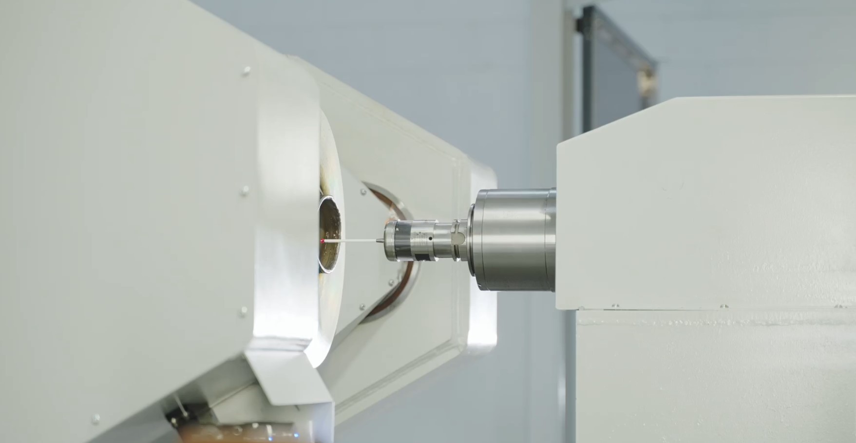

RMP60 probeRMP60 probe for measuring the workpiece
Mr Pearson reveals how Renishaw products were integrated into every machine process:
"We purchased two FORTiS systems they are plug-and-play, and very easy to install and set up. Renishaw also supplied us with an RMP60 probe system for measuring the workpiece, which works very well. They also developed for us a hybrid system that combines the NC4+ Blue laser tool setter for the milling tools and a RP3 tool setting probe for the turning tools."
