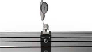

Installation guide: Probe On-centre adjustment [en]
This movie is a guide to Probe On-centre adjustment using a generic Renishaw Machine tool touch probe as part of installation, maintenance or problem solving.

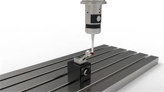

Machine tool probe calibration - Using ACS-1 [en]
How to movie - Machine tool touch probe Calibration using the ACS-1
