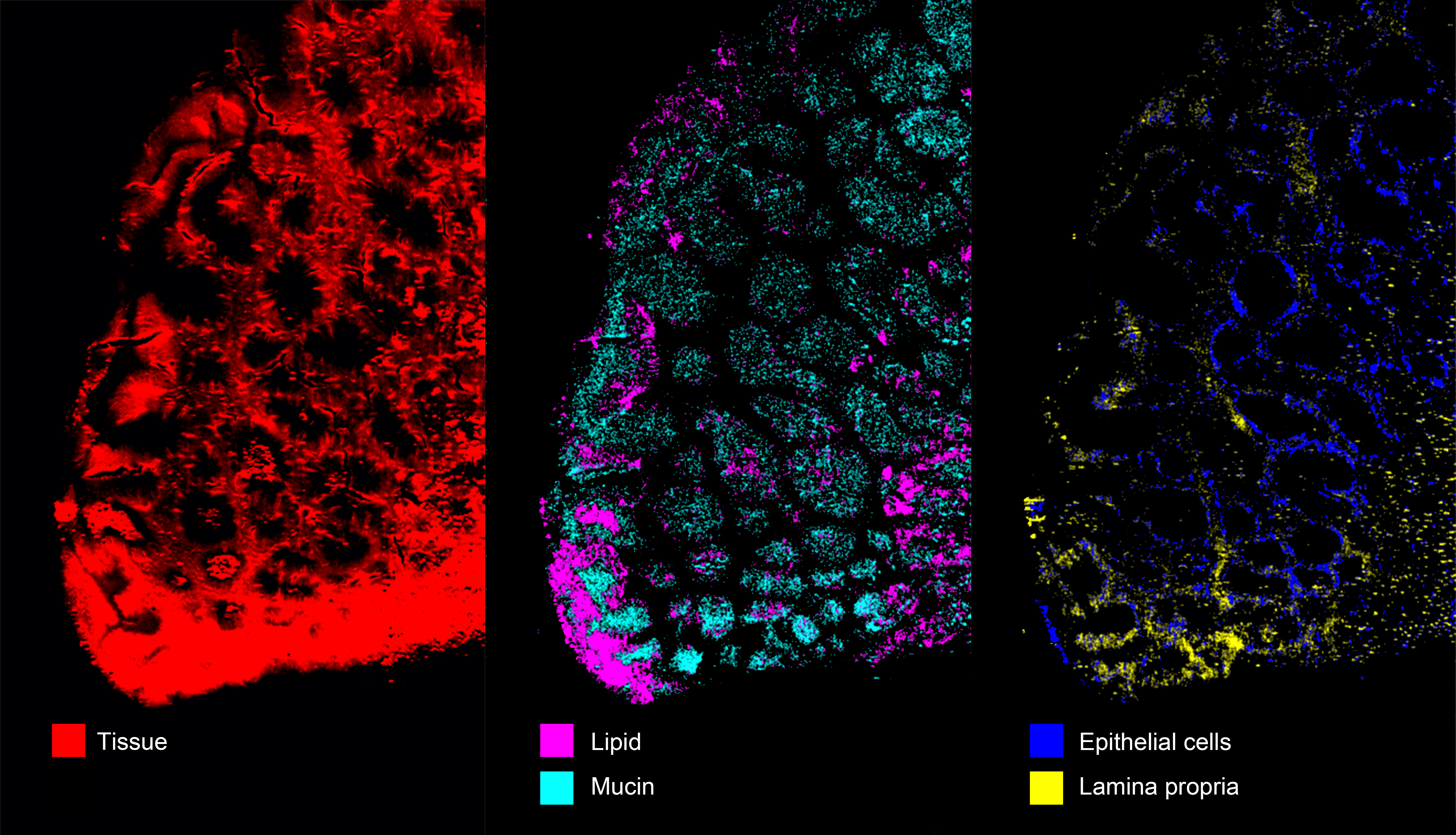

Renishaw's StreamLine™ technology is particularly suited to generating tissue images. Its line-focus geometry enables you to use high laser powers whilst avoiding photothermal damage to the tissue. This maximises signal levels and gives you images in the shortest possible time.
Study uneven surfaces
With StreamLine's Surface capability, you can generate images of samples, even if they are not flat.
