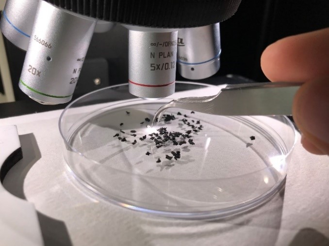

Microplastics are small, hard-to-spot, particles that make their way—from products and packaging—into the environment and cause significant pollution. The Danish Technological Institute (DTI, Aarhus, Denmark) is using a Renishaw Raman spectroscopy system to characterise the extent of microplastic pollution entering Danish wastewater and rainwater systems.

Morten Bormann Nielsen and his colleagues in the Life Science Division are currently developing new technology and methods for use in the environmental sector. When describing their work, Dr Nielsen said, “At scales below 100 µm (the width of a hair), it is essentially impossible to determine whether a particle is made of plastic, rubber, stone, glass or organic matter, based on its visual characteristics alone. Therefore, one must use a characterisation technique that yields chemical information about the investigated sample. Doing otherwise will lead to either gross over- or underestimation of the number and types of microplastic present in a sample.”

Dr Nielsen continued, “We wished to characterise the extent of microplastic pollution entering Danish wastewater and rainwater systems, as well as the degree to which these particles can be retained with different technologies. We also wanted to be able to identify microplastic and microrubber particles from tyres, as the Danish Environmental Protection Agency has estimated that up to 60% of all microplastics that enter the ocean from Denmark originate from this source – primarily via rainwater run-off from roads.”
Ensuring valid microplastic counts from environmental samples is extremely challenging, partly because the particles of interest constitute such a minute fraction of each sample (on the order of 150 milligrams per cubic metre of waste water). During isolation of the plastic particles, care must be taken to avoid contamination, and organic matter must be removed so it does not shield the particles. This requires a delicate chemical process that does not degrade the particles. DTI has the high level of expertise and advanced equipment required to achieve this.
