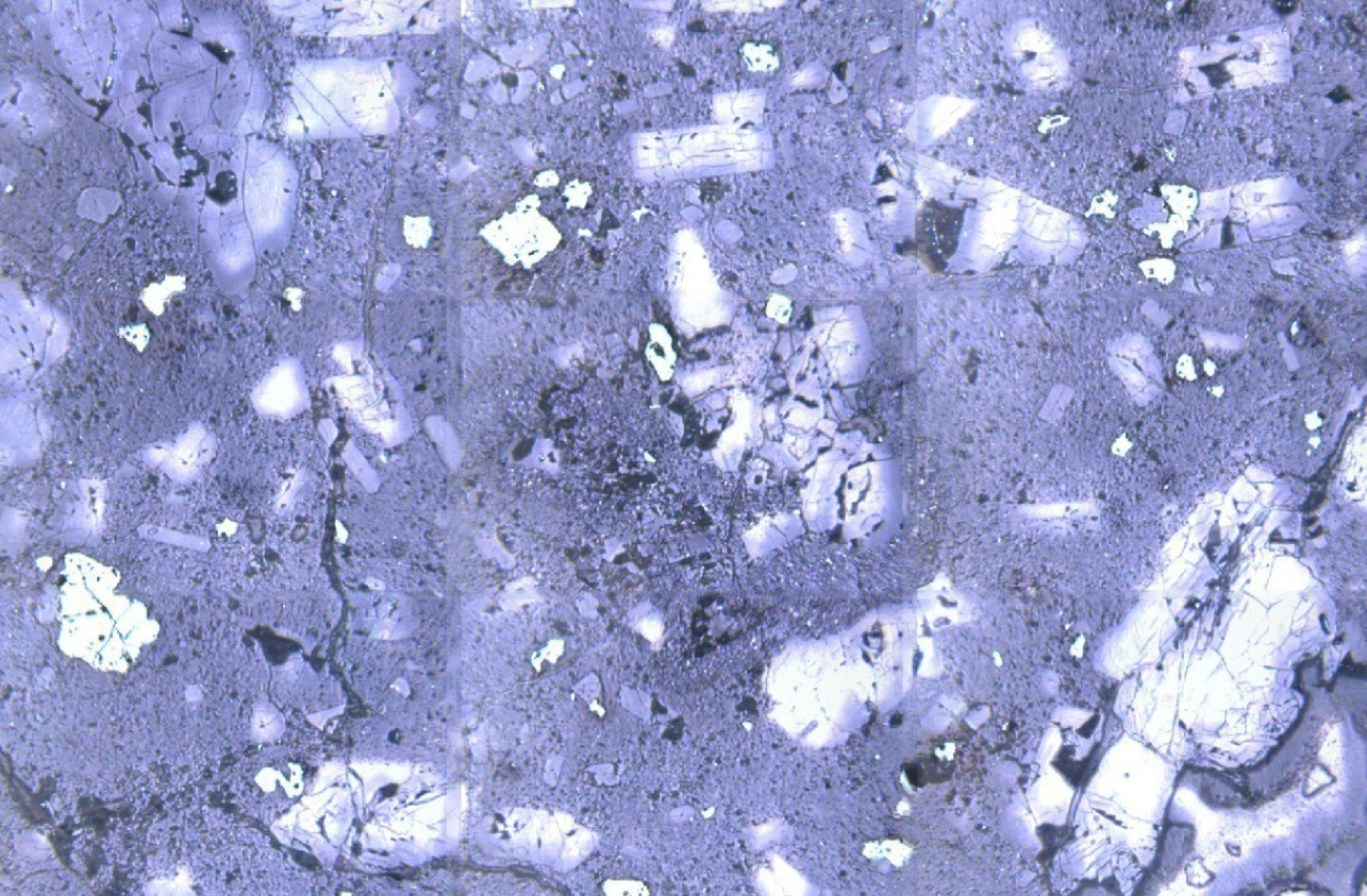

![EDS images of crinoid ossicle](/media/img/gen/a665b9c6403e47b3bd99bcb45e7e35c3.png)
EDS images illustrating the elemental composition in the geological section containing the crinoid ossicle. When combined with Raman spectroscopy, the identities and distributions of these minerals are revealed.
