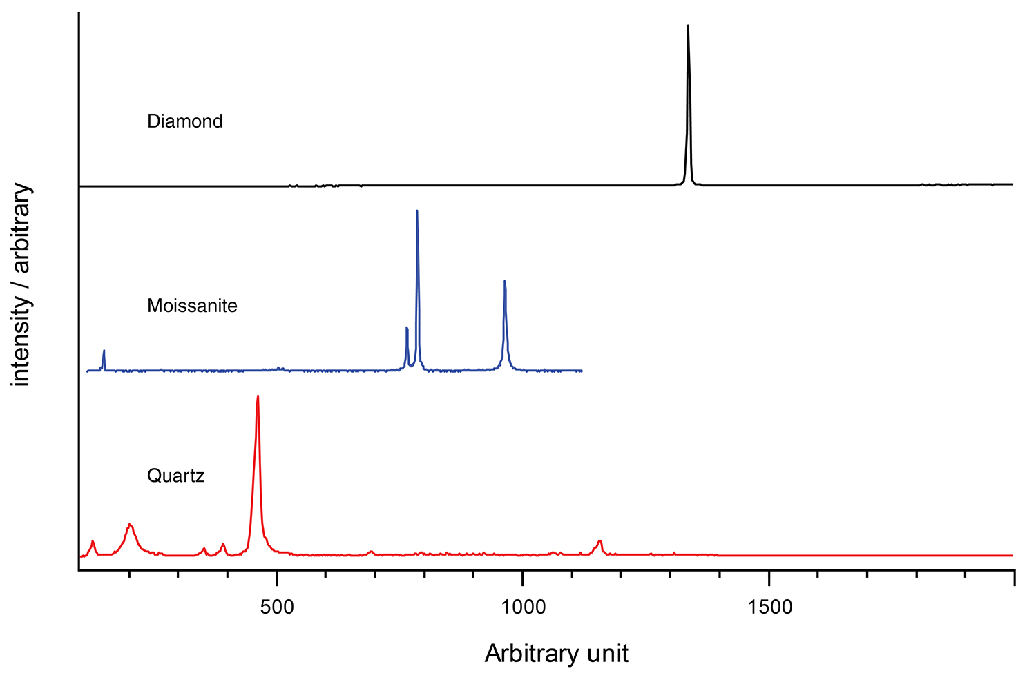

Gemstone identification
You can easily identify gemstones with Renishaw's Inorganic Materials and Minerals spectral database. Distinguish between diamond, moissanite, and other materials in seconds.
Detect adulteration
You can spot adulterated gemstones with Raman spectroscopy.
inVia's high spatial resolution and long working distance objective options enable you to see epoxy and other fillers in cracks, even if microscopic.
You can also detect heat and irradiation treated gemstones. A good example of this is the detection of the high-pressure high-temperature treatment of diamonds to modify their appearance.

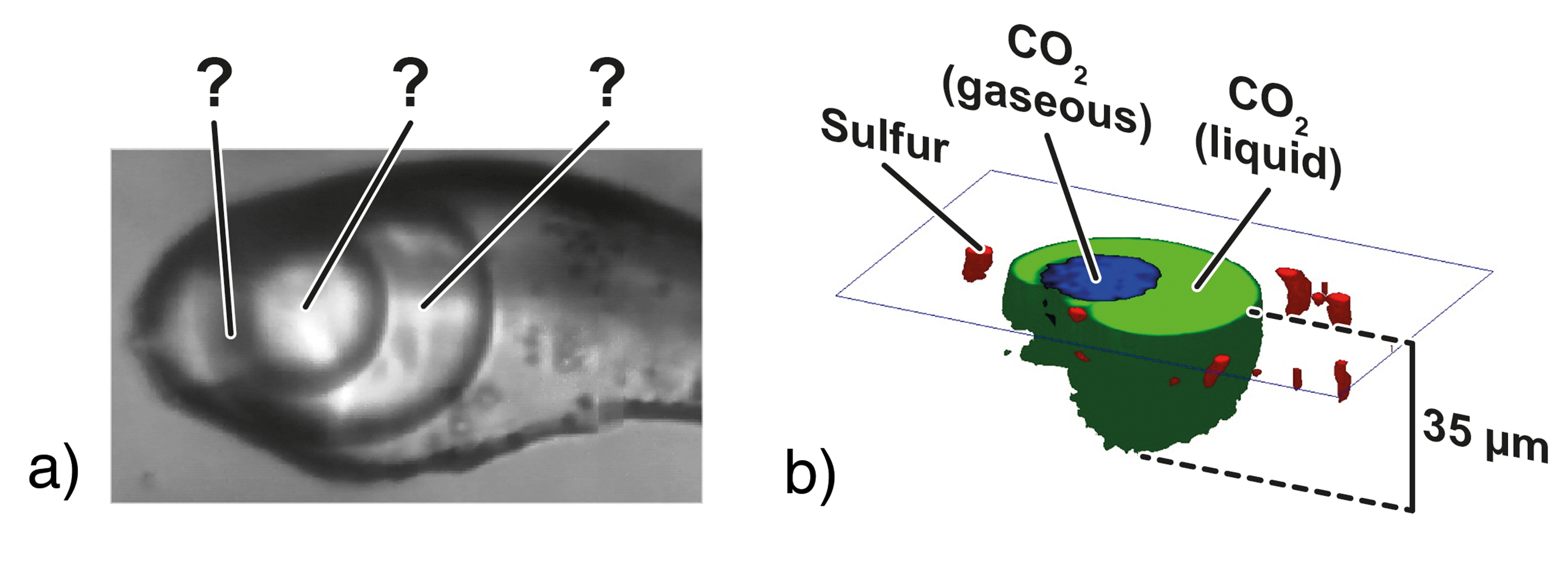

Investigate inclusions
Easily determine the composition of inclusions and visualise their 3-D shape with StreamHR™ fast confocal volume imaging. You can analyse not only solid inclusions, but liquid and gaseous inclusions too.
