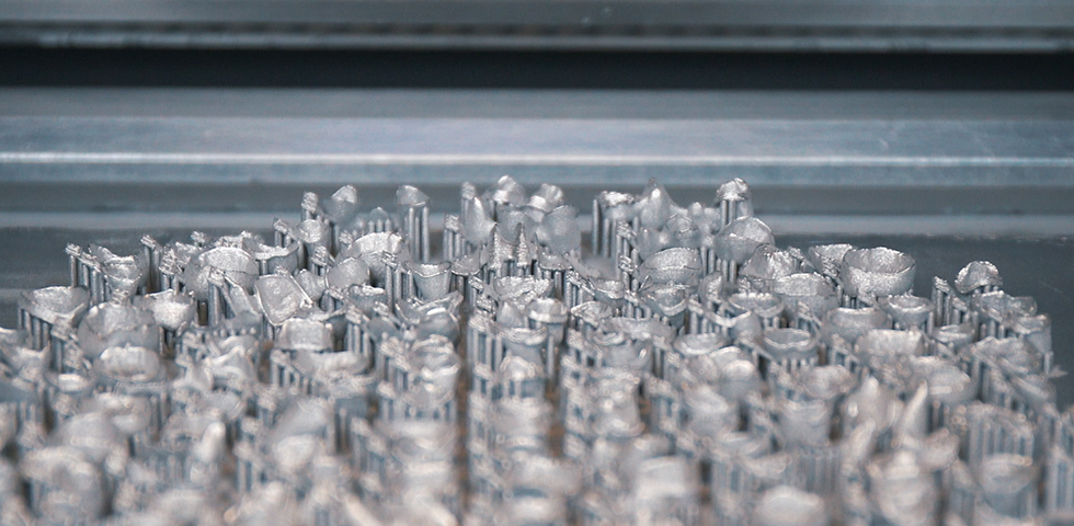

Build plate in Swift's AM250

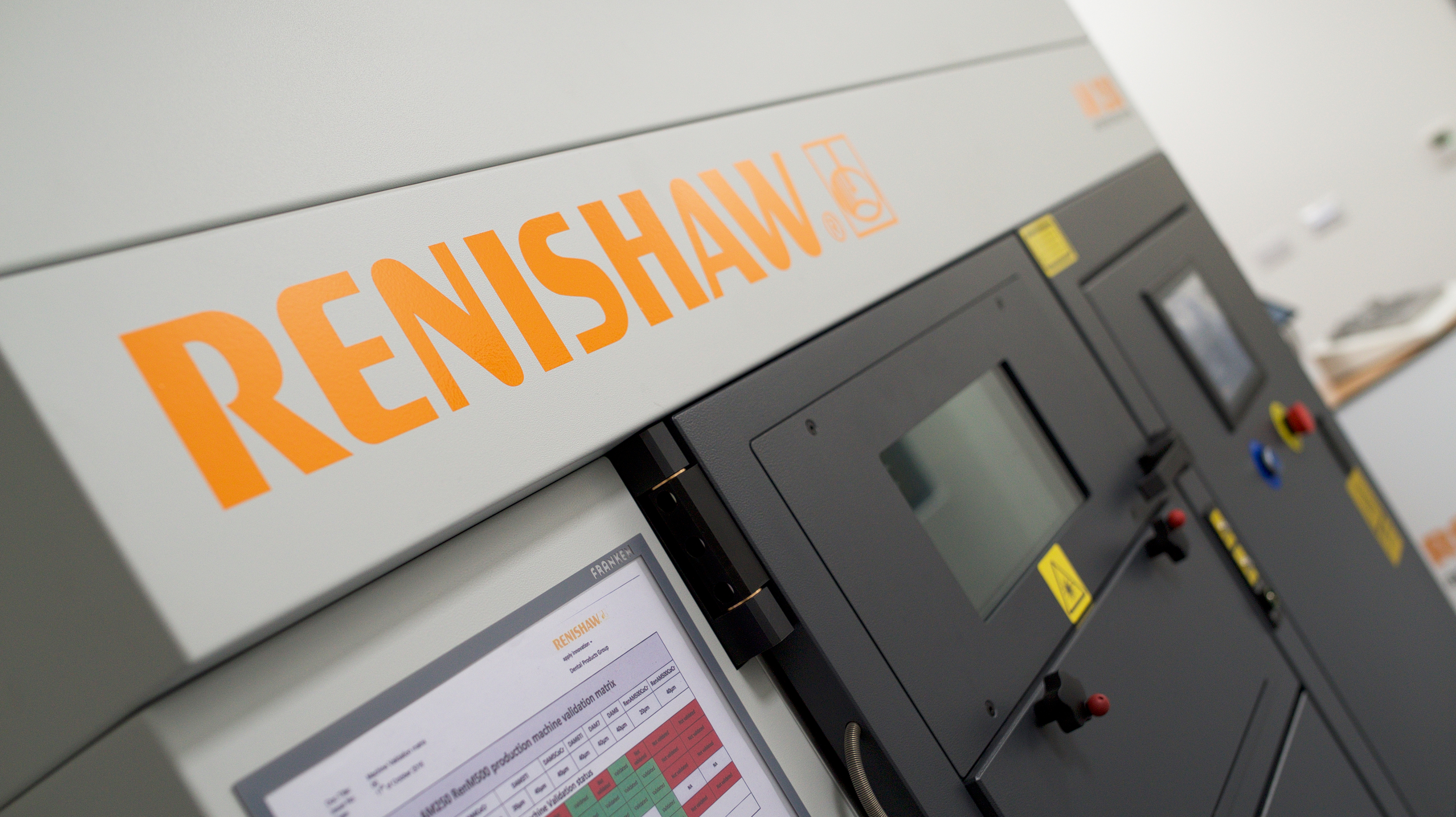

A partnership with Renishaw saw the introduction of additive manufacturing to Swift, fitting seamlessly into a newly implemented digital workflow. Renishaw supplied an AM250 system, which uses a high-powered ytterbium fibre laser to fuse fine metallic powders together to create a final three-dimensional structure.

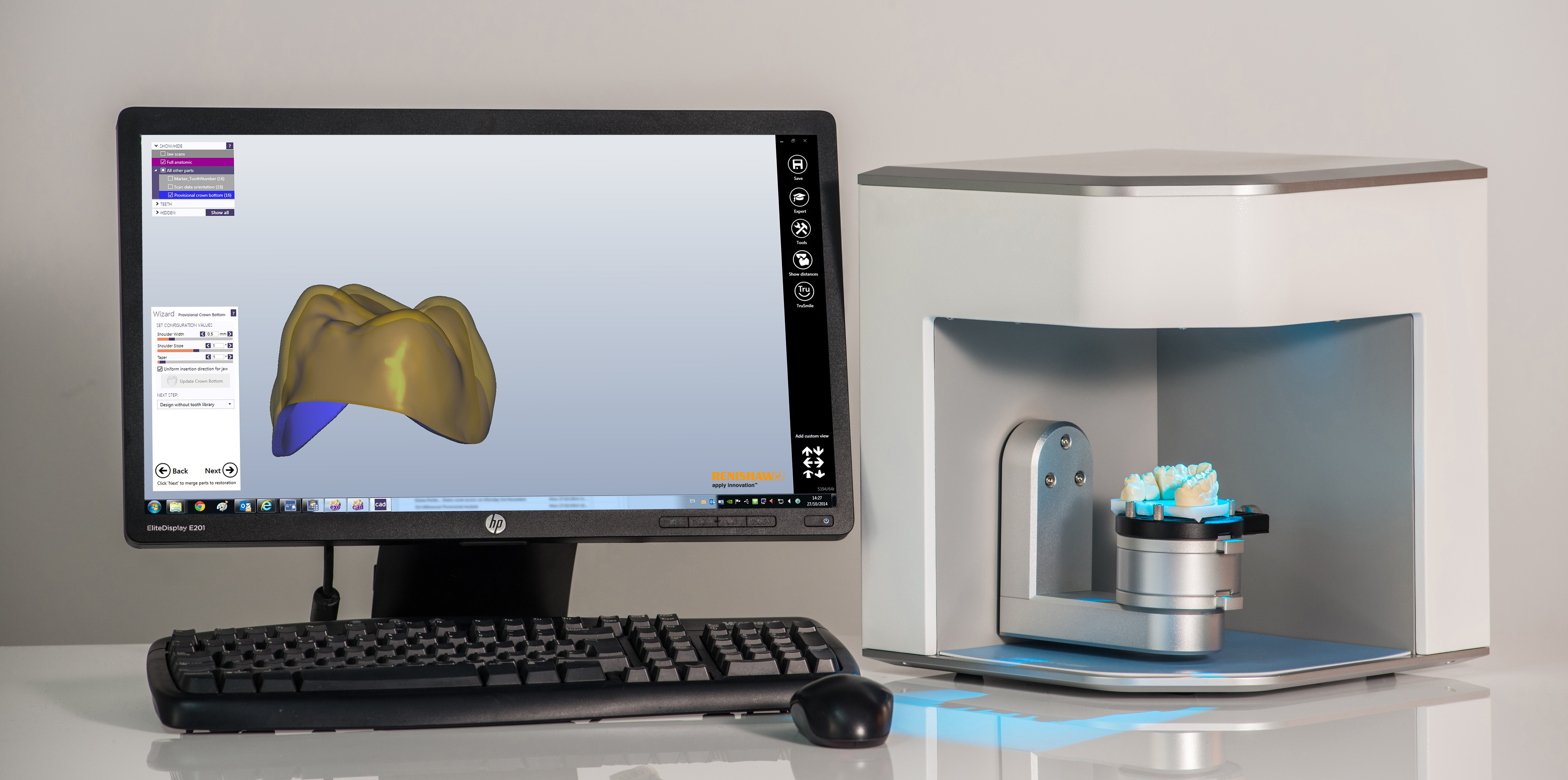

The AM250 is coupled with Renishaw's DS30 blue light scanner, which creates a digital copy of a dental impression or model. The dental frameworks are designed in Renishaw Dental Studio (RDS) and exported as 3D CAD data. These digital files are then sent to the AM250 and are produced from 40 micron layers of CE-marked cobalt chrome powder. Up to 300 dental frameworks, each with a unique ID tag, can be printed within eight to twelve hours.

Medit scanner coupled with Renishaw Dental Studio (RDS) for design
