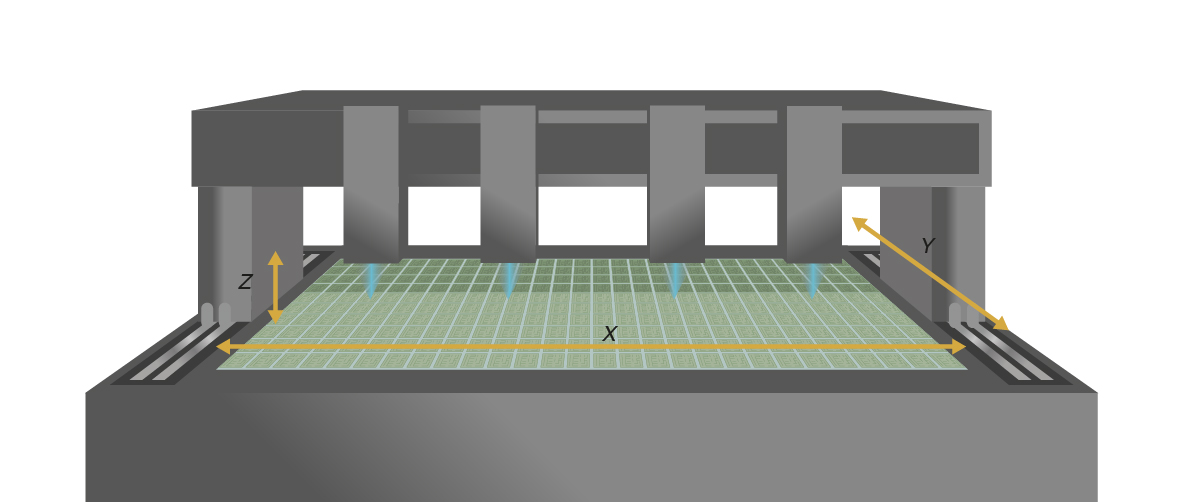

An example parallel-image writer system, shown in Figure 3, includes a parallel array of SLM imaging units, each unit comprising a SLM die, a spherical mirror, multiple illumination sources and a projection lens assembly, as shown in Figure 2. The SLM die is a MEMs (Micro-Electromechanical Systems) device under incident light with thousands of controllable micro-mirrors that tilt to create a high-contrast light and dark mask pattern in the lens focal plane. Precise motion control is needed to coordinate both the imaging unit and the larger substrate motion stage underneath. In this case, the substrate moves along the X-axis and the SLM unit moves along the Y-axis, like a print head. Both stages are supported on air-bearings and are driven by linear motors.
A vision system may be employed to guide the imaging units via reference markers on the substrate stage. This type of system could also be used with roll-to-roll flexible substrates.
