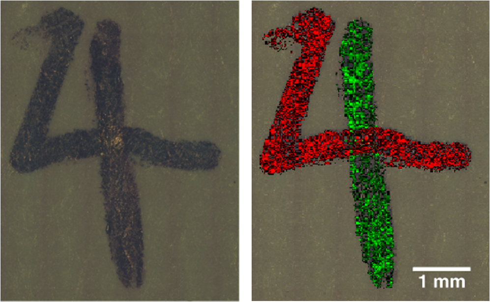

Raman images, sometimes referred to as maps, show the spatial distribution of spectral information across your sample. We use a Raman microscope to collect the spectral information from an array of points on—or in—a sample. Raman imaging can easily show changes in chemical and structural properties with position as 1D profiles, 2D areas or 3D volumes.

False colour Raman images are a powerful way to emphasize the distribution of chemical and structural properties within a sample. The brightness, contrast and colour of the image can help to represent material composition. By overlaying individual Raman images, you can display the distribution of multiple species or properties at the same time.
