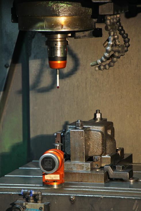

The Primo system was installed on a machine used for the precision machining of pump body castings and steering worm shafts.
In the case of the pump body casting, establishing a datum edge accurately to avoid wall thickness variation was critical. Previously the rejection rate due to variations in wall thickness had been 12%. Using the Primo system provided an automated part setting capability that was accurate and reliable, completely eliminating rejections of
this kind.

SuMax case study: Pump body casting being probed for wall thickness variation with the Primo system
