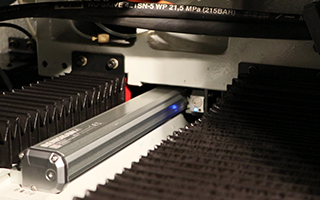

FORTiS™ enclosed encoder inside TGT's tool grinding machine

The X-axis and V-axis slides are attached to separate FORTiS encoder readheads but use the same enclosed absolute scale of the FORTiS dual-readhead system. The readheads feedback the X-axis position of the workpiece and V-axis position of the V-block, each with a resolution of 10 nm, to the controller. In this case, the FORTiS encoder enables a positioning accuracy of 3 µm on an axis with 150 mm of travel.
One of the major advantages of using the FORTiS dual-readhead enclosed encoder is that it simplifies the mechanical arrangement of the machine, which saves space and reduces cost. “One benefit of choosing the FORTiS dual-readhead linear encoder is that it enables faster and simpler encoder installation and servicing,” said Mr Ranganatha.
FORTiS optical enclosed encoders have an innovative non-contact mechanical design that eliminates components such as bearings, springs and guidance carriages. This design minimises wear and greatly reduces the risk of breakage during maintenance and servicing, thereby extending the life of the system.
FORTiS encoder readheads are equipped with Renishaw's patented set-up LED, and carefully designed installation accessories to ensure intuitive and right-first-time installation that is substantially faster than more conventional systems, even in restricted locations.
For enhanced functionality, installers can connect the Advanced Diagnostic Tool, ADTa-100, via a standard USB connector, to a PC running Renishaw's ADT View software. This provides a user-friendly graphical interface of advanced diagnostic information, including key encoder performance parameters such as signal strength along the axis length.
TGT technicians use the ADTa-100 hardware to connect the FORTiS encoder to the ADT View software interface during the machine assembly process. This software provides a snapshot of the real-time signal strength at different positions along a machine axis such that the technician knows where to make fine adjustments and can even enable calibration of the FORTiS encoder with the machine powered down.

FORTiS encoders are quick and easy to install, which has helped TGT to save manufacturing and servicing time.
Mr Ranganatha explained, “The installation of the FORTiS enclosed encoder is very simple, which has greatly improved our productivity. Using the ADTa-100 tool and after receiving the appropriate Renishaw training, our engineers can complete a single-axis installation in only 15 minutes. If only the readhead LED were to be used, I believe the speed would be even faster. The LED allows us to quickly determine the status of the encoder, improving diagnostic accuracy when the machine is faulty.”
