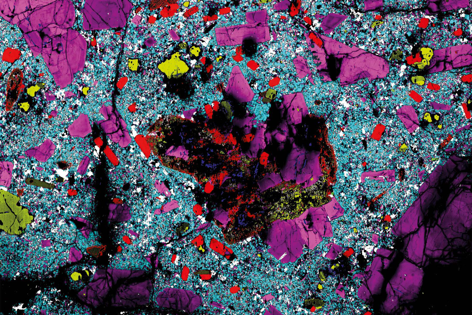

  • volcanic rock Raman
    Raman overlay image of volcanic rock
