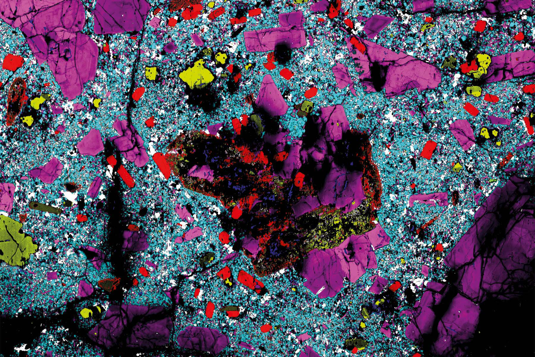

Raman images used to be small and highly pixellated. Not anymore!
Now you can collect and analyse massive data files (spectral hypercubes) and produce large high definition chemical images.
Renishaw's engineers have developed a file format (WDF) and optimised WiRE™ software to handle very large Raman datasets (over 50 million spectra). With this, you can collect and analyse data files to produce megapixel sized images. You can collect these HD images at phenomenal speeds using Renishaw's StreamHR™ Rapide.
Superior image quality
Samples are often inhomogeneous, containing a variety of particle sizes and distributions. With WDF and WiRE, you can see small details even over very large areas. Your information will be more accurate and representative when compared with more limited file sizes, where either the step size needs to be larger (missing detail), or the analysis area is made smaller (becoming less representative).
A capability with no constraints
Renishaw has designed the WDF file format to be fast and efficient. There is no inherent file size limit so, should you wish to, you can record tens of millions of spectra in a single file.
We have optimised the processing and analysis options in WiRE to ensure you can rapidly work with such large files. Moreover, WiRE is written so that it can embrace future computational power increases, such as expanded memory and faster multiple processors.
