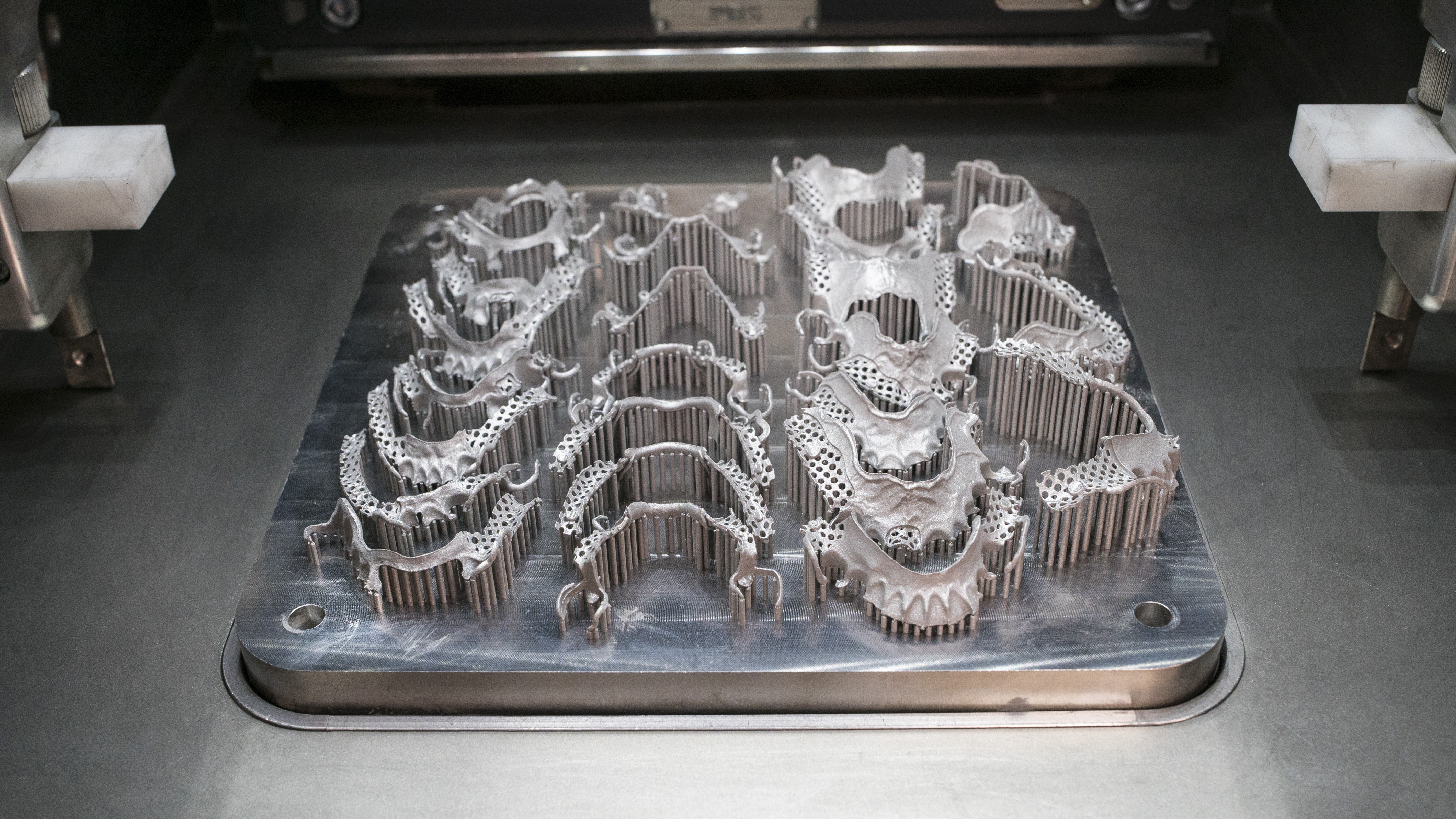

The most accurate method on the market to manufacture removable partial dentures is additive manufacturing. However, incorporating this technique involved significant change to the company's internal processes and business model.![RPD build plate](/media/img/gen/239d8315e4514bc4a67b67f039428f36.jpg)

Impressed by the quality of the sample parts, Proslab purchased Renishaw's AM 400 metal additive manufacturing system. The machine enables the production of removable partial dentures directly from a CAD file, eliminating the additional casting step. Frameworks are built in 40-micron layers of CE marked cobalt chrome powder and built by laser powder bed fusion (PBF), using a high-powered ytterbium fibre laser.

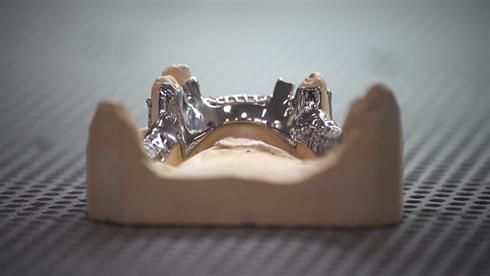

![RPD polished on stone model](/media/img/gen/1c1f45a6ca564b0cb593fc5f5e167714.jpg)
