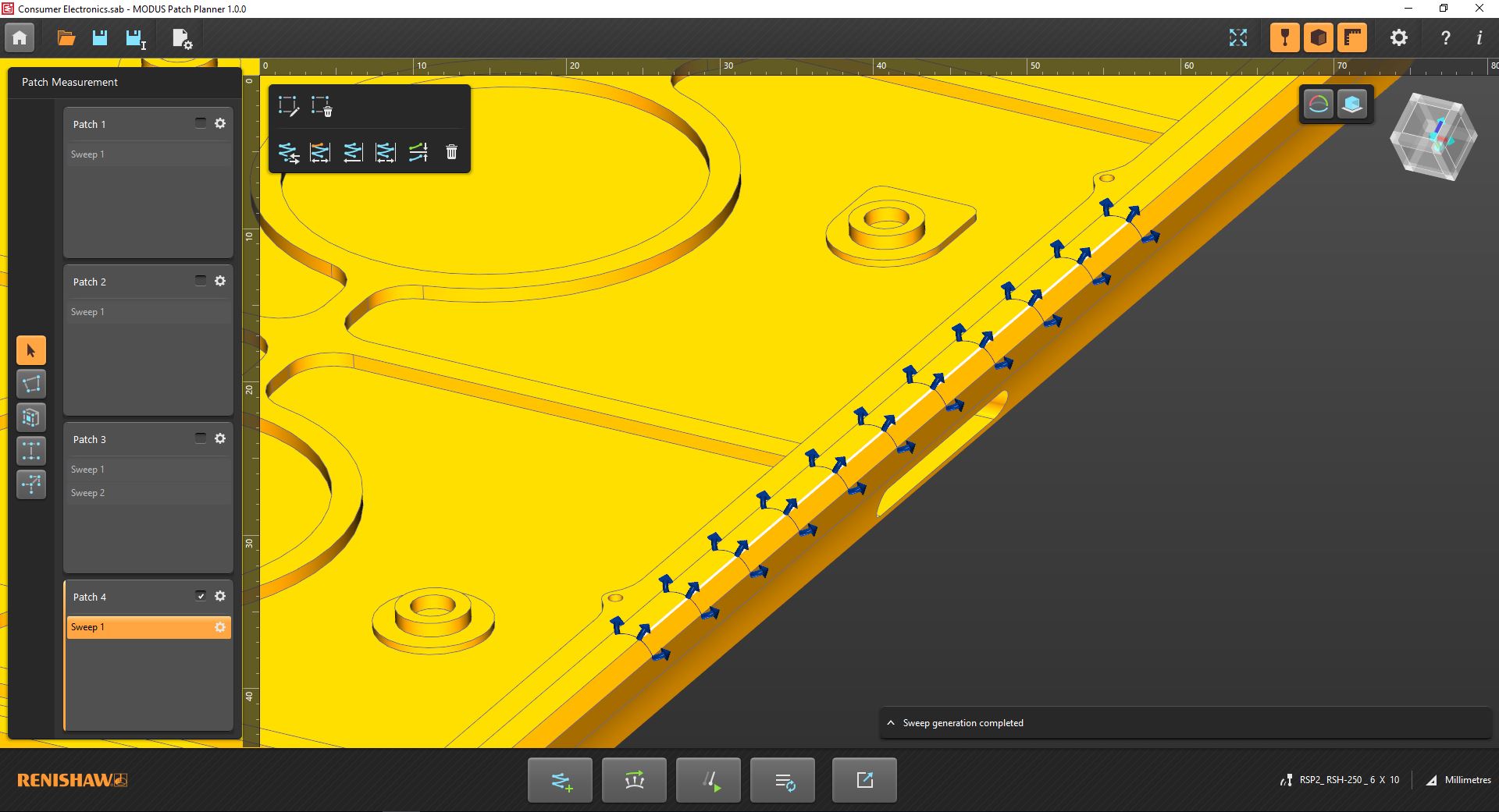

MODUS Patch delivers the most efficient measurement path with the REVO RSP2 sensor, quickly and easily, with automatic on-surface planning of sweep scans.

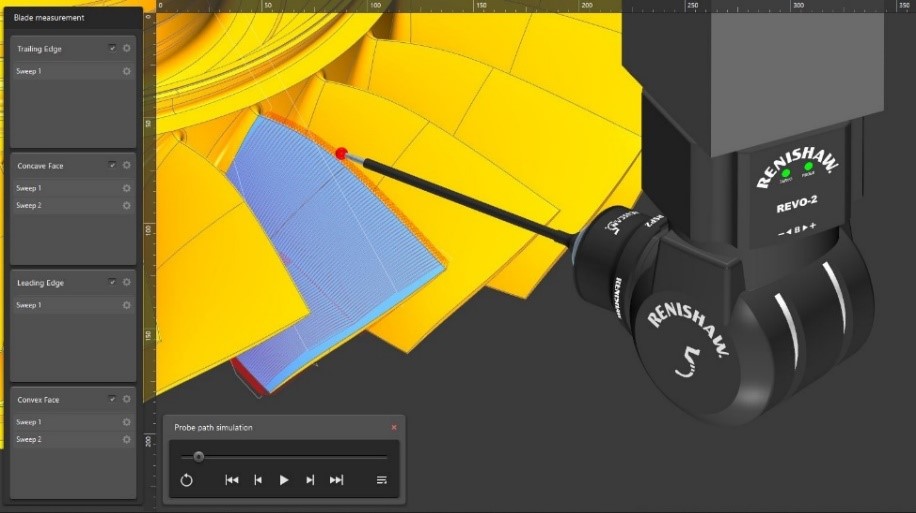

The latest addition to the MODUS Planning Suite, MODUS Blade, enables the user to plan sweep scans on concave and convex, leading and trailing edge surfaces. The settings and measurement strategies allow the user to customise the measurement paths, providing the ability to control the number of sweeps per surface and change the direction of measurements between longitudinal and transverse sweeps, facilitating the full blade inspection.
