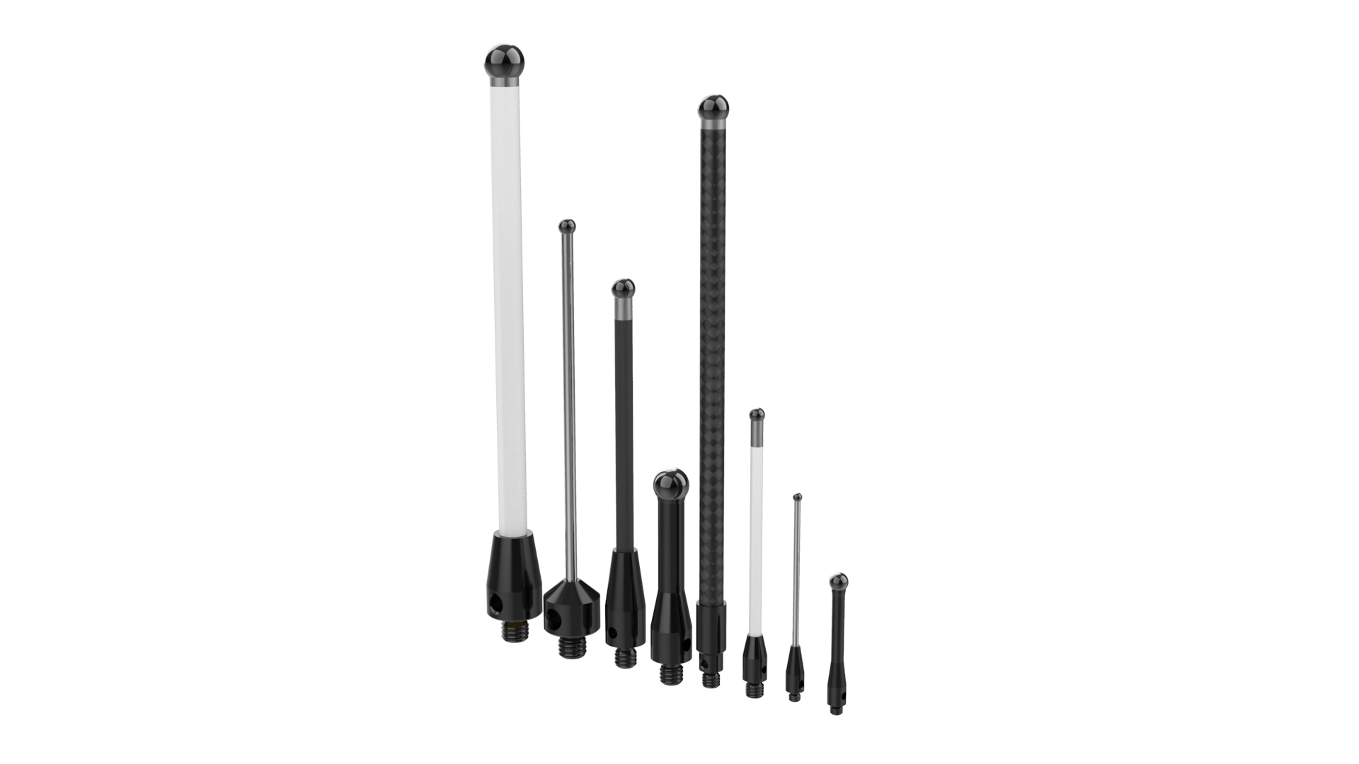

The OPTiMUM diamond styli range has been specifically developed for use within metrology applications that require a hard-wearing stylus. The principal advantage of its diamond coated spheres is that they will maintain their roundness and will not suffer material ‘pick up' or premature wear when scanning abrasive materials or soft alloys. This provides multiple benefits including an increased working life, and reduction in recalibration and inspection downtime.
Built to order, OPTiMUM diamond coated styli can be made in multiple thread sizes and stem materials, with ball sizes from 1.5 mm up to 8 mm to suit specific applications. The range will support the increasing need for high performance and speed in scanning applications, coupled with market-leading product availability and price.
