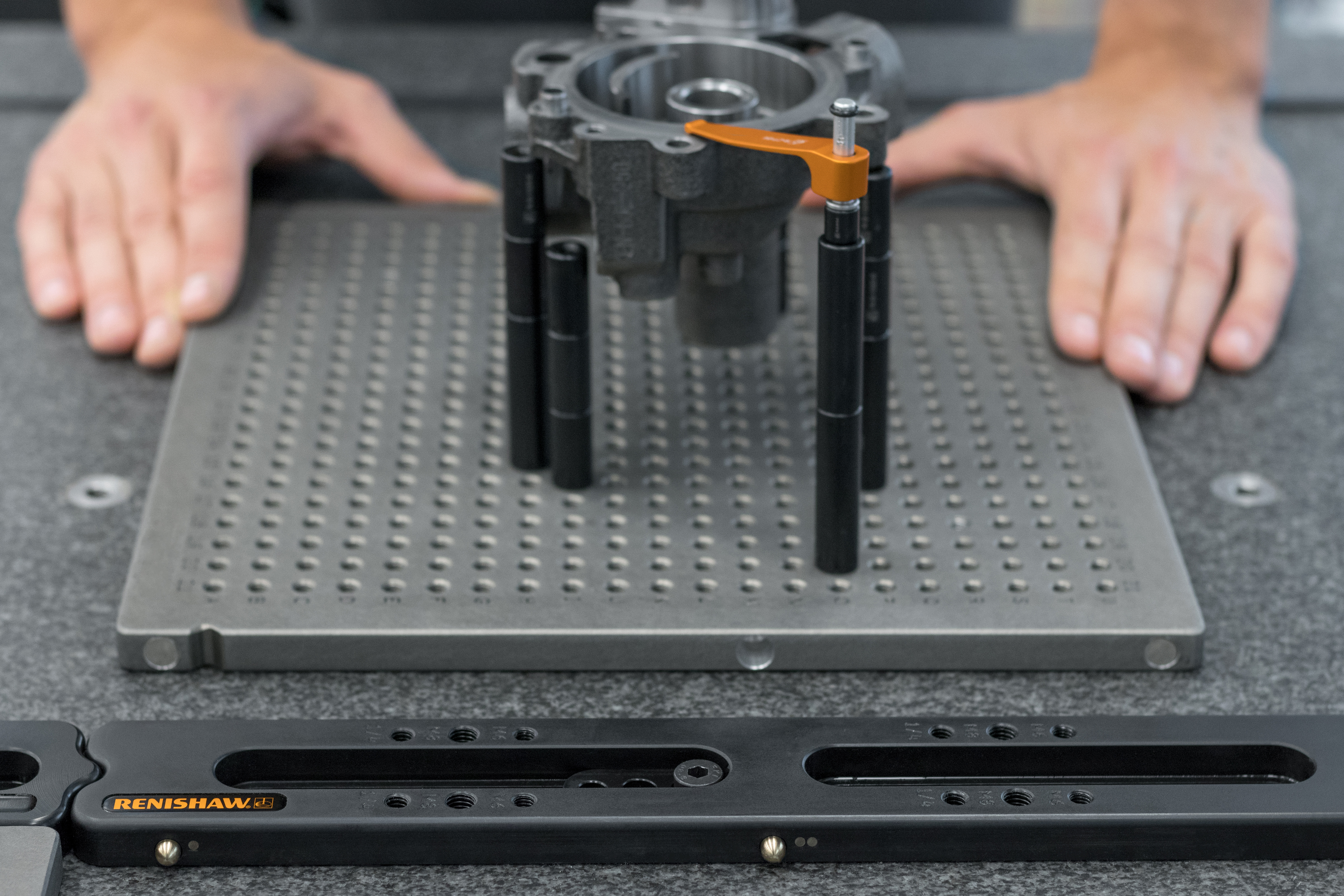

CMM fixtures
Our components allow you to fixture workpieces of almost any size, shape or material onto your measuring bed. Our wide range of metrology fixtures for CMMs and Equator gauging, includes a choice of standard size base plates and an extensive selection of components with M4, M6, M8 or 1/4-20 threaded fittings.
Whether you are inspecting workpieces for aerospace, automotive, electronics, industrial or medical applications, Renishaw can provide a complete fixturing solution for any workpiece regardless of its size, shape or material.

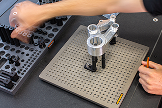

Maximise inspection throughput whilst maintaining flexibility
To minimise unproductive set-up time, whilst maintaining fixturing flexibility, workpieces can be fixtured on a base plate away from the CMM, vision machine or Equator gauging system. The fixtured workpiece can be loaded onto the inspection device with ease, immediately prior to measurement.
Filling the measurement area of a CMM with multiple fixtured parts is another way to minimise set-up time. Multiple workpieces on the CMM bed can be measured in one batch, without the need to start and stop the measurement cycle to load more fixtured workpieces.
A large range of components
Our modular CMM fixtures can be used to secure parts of almost any size, shape or material. Base plates and components are available as standard in M4, M6, M8 metric and 1/4-20 imperial thread sizes.
With a range of fixturing solutions available in our Online store, your fixture collection can be expanded when your requirements change.

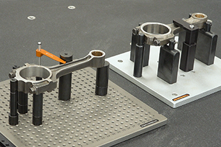

Reproducible set-ups
Identical fixturing set-ups are important to ensure the repeatability of inspection by removing variation from the process. Set-ups can be accurately documented and reproduced using our alpha-numerically labelled base plates and labelled fixturing components.
Fast assembly
Fixturing solutions can be assembled very quickly to increase throughput and avoid delays in inspection. All components are hand-tightened and require no special tools.

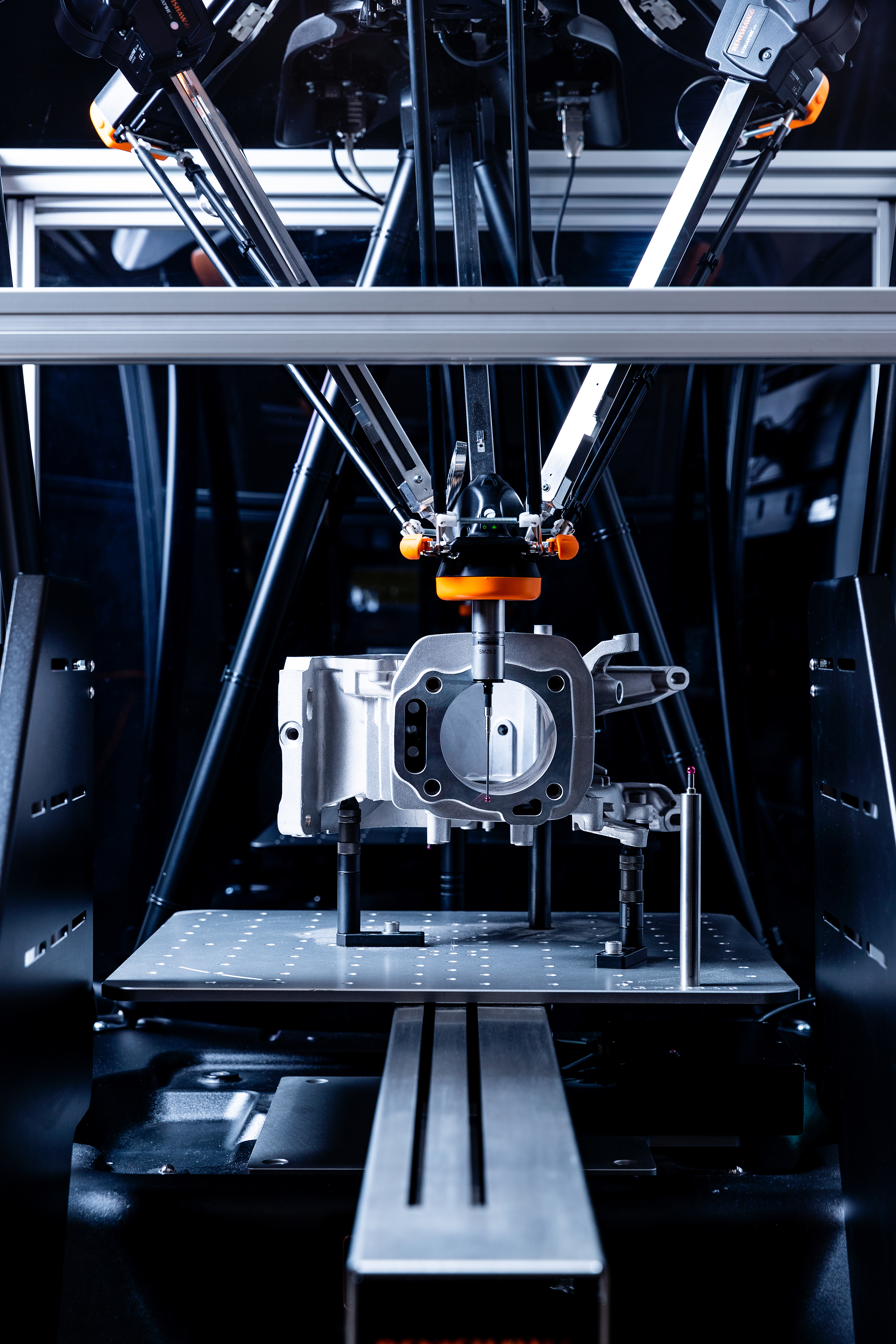

Metrology fixtures for Equator™ gauging
Our Equator fixtures have specifically designed base plates with a 3-point kinematic system allowing for quick loading and unloading on to the machine. The positive engagement of the base plate ensures each fixture is repeatedly located and securely held in place, allowing quick changeover of parts on and off the Equator within seconds.
Using Renishaw Equator fixtures can improve the throughput, reproducibility and accuracy of your inspection process with quick and repeatable fixturing set-ups that are easy to configure:
Base plates are alpha-numerically labelled so set-ups can be documented and repeated quickly and accurately.
Fixturing components can be easily positioned for minimal contact on and around the part, providing an unobstructed probe path for inspecting every detail on the part.
Base plates are available in M4, M6, M8 or 1/4-20 thread sizes and made from cast aluminium coated with hard coat anodise to reduce wear and scratching.
