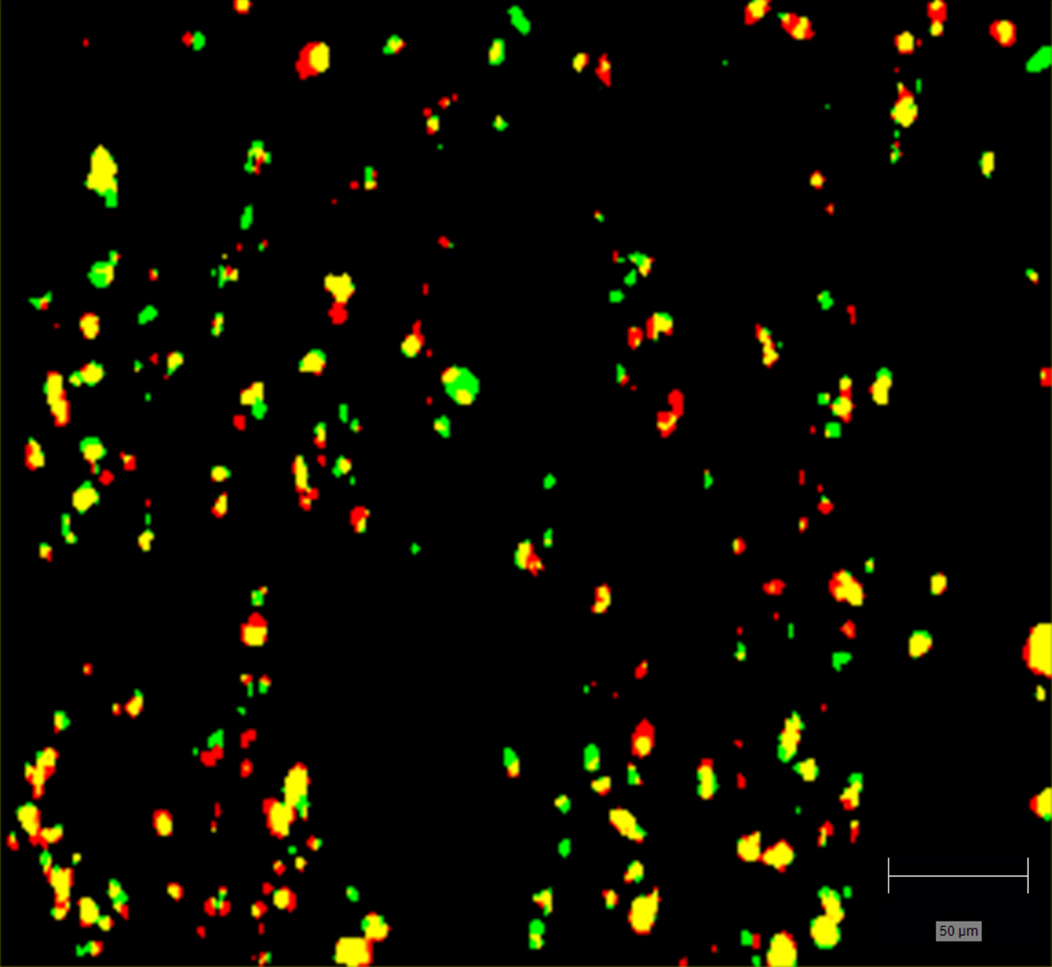

  • StreamLine Raman image showing inhaler active pharmaceutical ingredients
