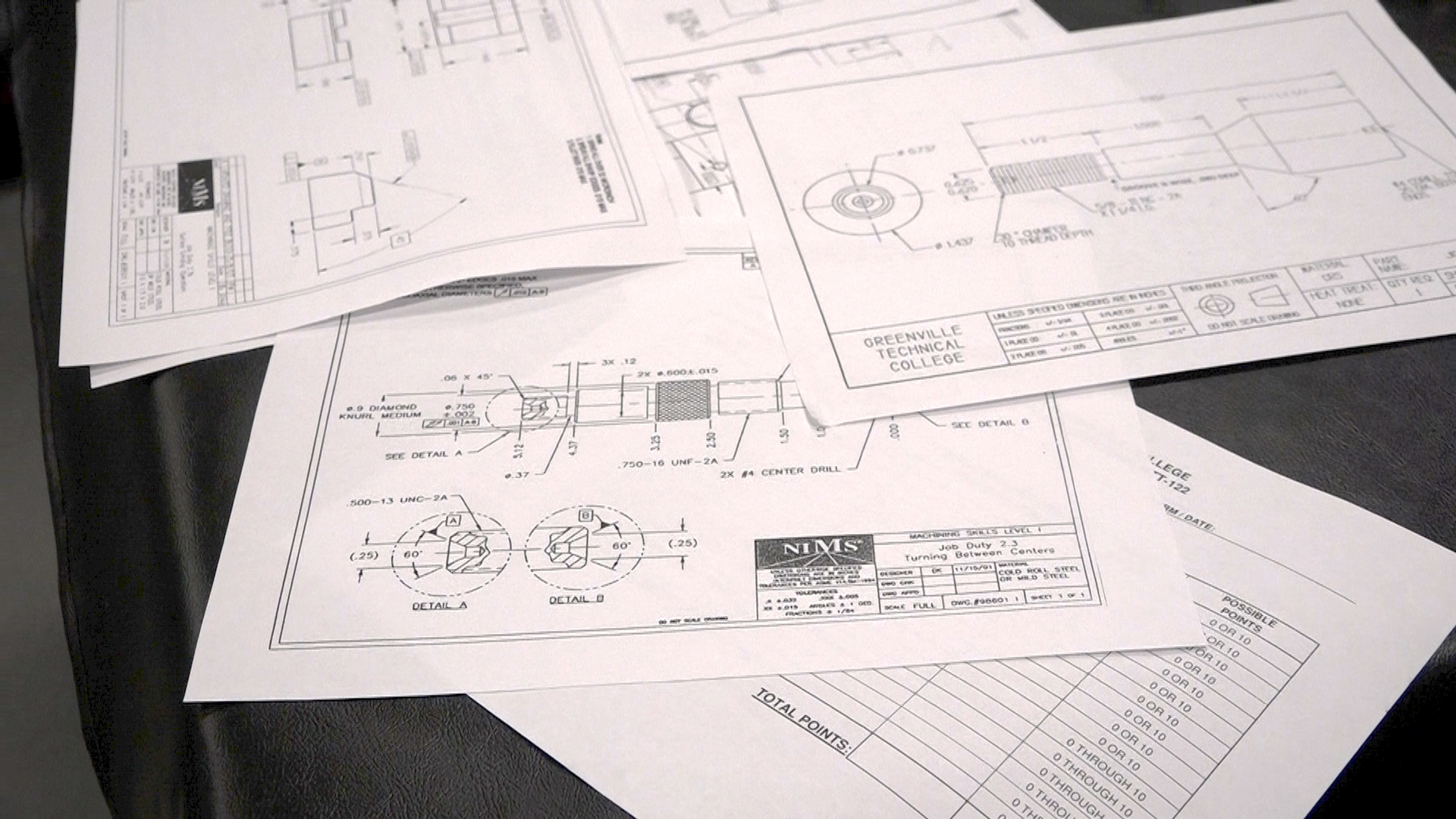

To validate the students' machined NIMS parts, all features are measured, including geometric dimensioning and tolerancing (GD&T), as well as plus or minus tolerances. When each measurement meets specification, the part passes inspection. Once they pass both inspection and a technical test from an instructor with a NIMS Inspector credential, the student will receive their certification.

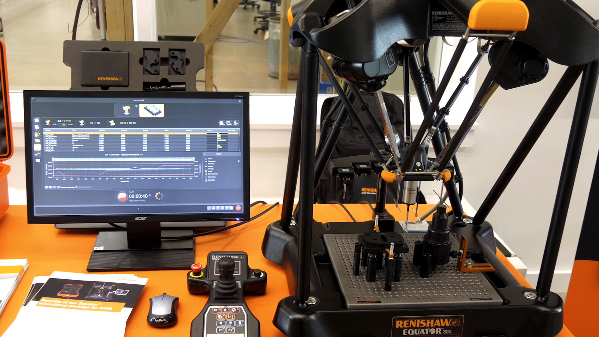

The Equator gauge is a flexible system that provides speed, repeatability, and ease of use for manual or automated measurement in machine shop environments. Its integral re-mastering process also means that the Equator system does not require annual machine calibration.
The prewritten programs include proven gauging programs for each part required for NIMS certification. The package also includes styli, two metrology fixturing plates, and fixtures that can fit all 13 parts, providing everything needed to inspect the parts. The system also features a user-friendly operator interface, allowing easy program selection and execution, and a clear display of results.

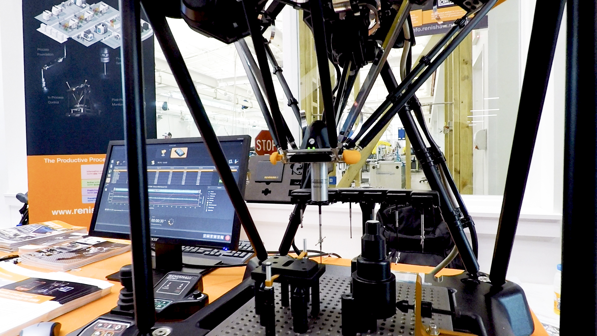

Demonstrating the Equator gauging package for NIMS at the annual Haas Tech (HTEC) Conference

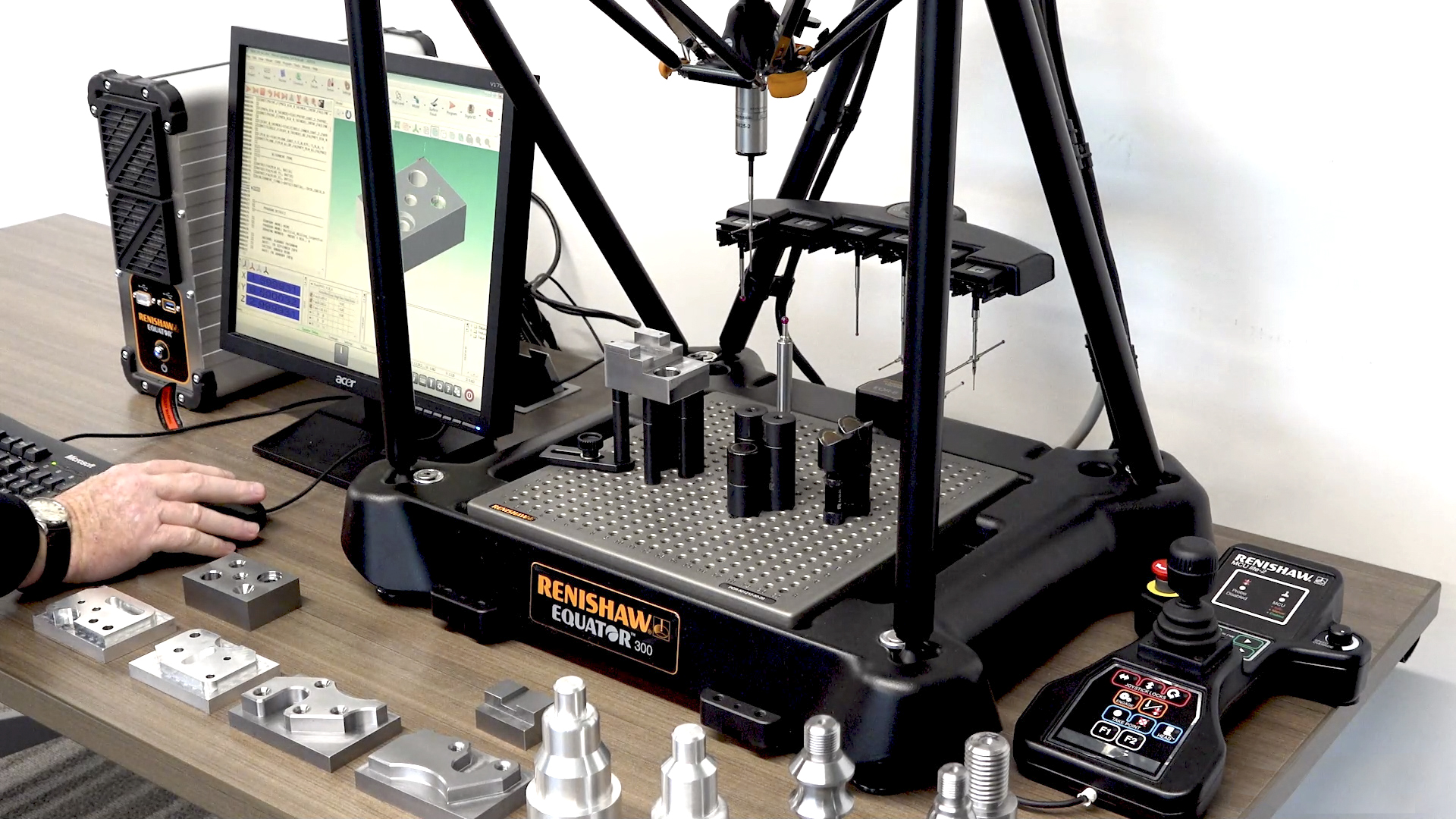

Renishaw's Equator gauging system inspecting a NIMS machined part
The NIMS inspector credential has been hugely beneficial as it has enabled schools to inspect machined parts in-house. However, it can also be difficult to check in-volume parts consistently and in a time effective manner. The Renishaw Equator package has enabled students to inspect their own parts and know within 3 minutes if their part has passed or failed, teaching them where they have made any mistakes and immediately how to resolve them.
