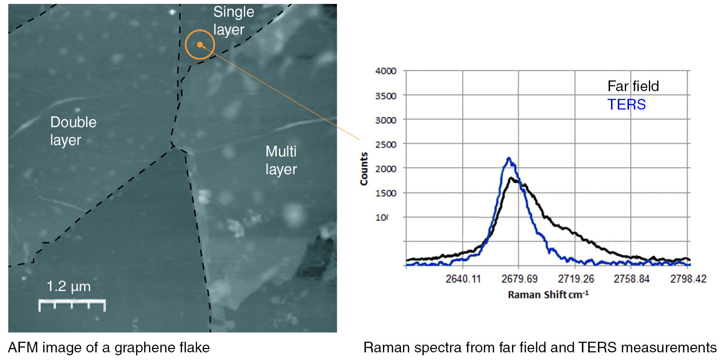

Renishaw can combine Raman analysis with scanning probe microscopes (such as atomic force microscopes). These systems add chemical analysis capabilities to the high spatial resolution topography and property information acquired by SPMs/AFMs. You can also use tip-enhanced Raman spectroscopy (TERS) to acquire nanometre-scale Raman chemical information.
