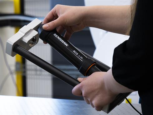

RCS L-90 is built on established Renishaw metrology expertise and technology.
The automation of manufacturing operations is now accepted industry practice. However, factories are facing up to the challenges associated with this. Renishaw offers an unrivalled breadth of metrology technologies and decades of experience in automated manufacturing and process control. This expertise and experience has combined to produce the RCS series of products.
The ballbar itself is constructed around a Renishaw linear encoder. Beyond that, we issue calibration certificates at production and after servicing - guaranteeing precision.
A person placing an RCS L-90 ballbar into an RCS calibrator
