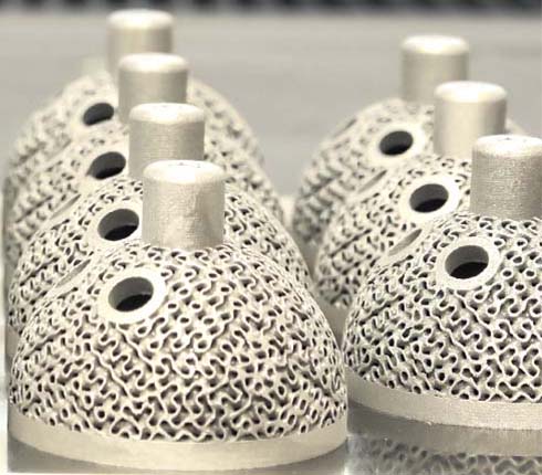

3D print file generated using QuantAM build preparation software
Acetabular cup build in progress on RenAM 500M AM system

CPM has invested in a RenAM 500M additive manufacturing system, which they use to 3D print medical devices in titanium. Renishaw's AM technology can produce complex structures in one manufacturing operation. As an example, CPM has begun assessing the use of gyroid lattices on acetabular cups, a design feature which would not have been economically feasible to produce before their investment in AM. The resulting implants have stood up to rigorous quality testing, and CPM report notably good density and Young's modulus values.

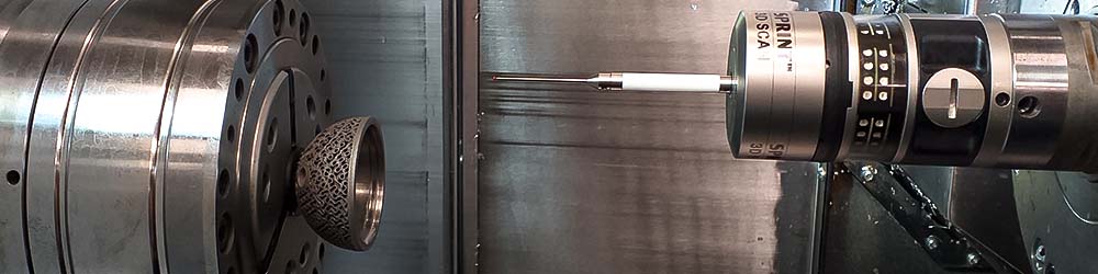

In-process inspection with Renishaw OSP60 probe with SPRINT™ technology

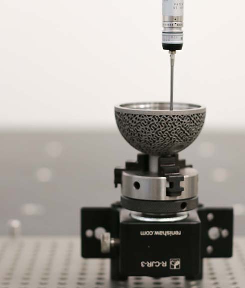

Post-machining inspection with Renishaw PH10 CMM
Post-machining inspection with Renishaw PH10 CMM probe
