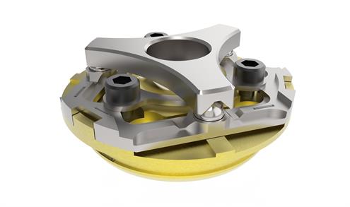

Renishaw high-accuracy probes deliver superior measurement performance by utilising advanced probing mechanisms, with either RENGAGE™ technology or micro-kinematics. These technologies enhance and ensure first-time-pass machining of parts, including complex components with soft, flexible and intricate 3D shapes.

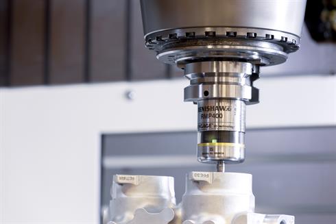

Renishaw RMP400 probe on a machine probing a bore on a machined part
RMP400

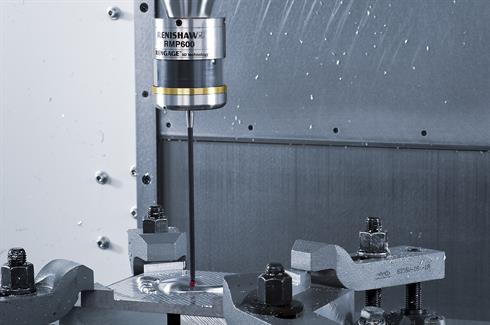

Renishaw RMP600 Rengage probe probing a part on a lathe
RMP600
The ultra-compact RMP400 measures just 40 mm in diameter, whilst the compact RMP600 measures 63 mm. Both probes offer an exceptionally reliable probing solution for larger machines or installations.
  • RENGAGE™ technology combined with radio transmission for hassle free probing.
  • Operating range of up to 15 m.
  • Unidirectional repeatability of 0.25 µm 2σ.

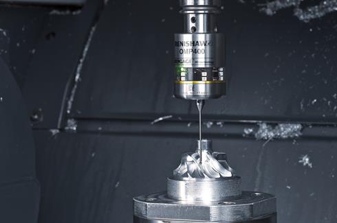

OMP400 and NC4 prismatic part
OMP400
Renishaw high-accuracy optical OMP600 probe on a nodding head machine
OMP600
Measuring just 40 mm in diameter, the ultra-compact OMP400 probe is ideal for users of small to medium machining centres. Whilst the compact OMP600, 63 mm in diameter, is suitable for all sizes of machining centres.
  • Proven and patented with RENGAGE technology.
  • Secure and robust infrared transmission with operating range up to 5 m (OMP400) and 6 m (OMP600).

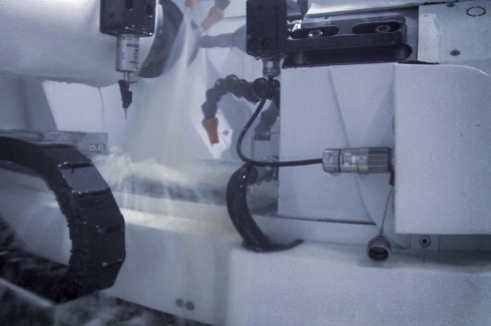

MP250 is a hard-wired probe best suited for particle-laden environments commonly found in grinding applications. For high vibration applications, the probe can be switched to a more vibration-resistant configuration.
MP250 high-accuracy inspecting fluted tool
MP250
Designed for a minimal footprint and maximum capability, the miniature and versatile MP250 is just 25 mm in diameter and 36 mm in length – providing process control even in the smallest and most harsh machining environments.
  • RENGAGE technology for exceptionally reliable measurement over a long service life.
  • Battery and interference free with hard-wired connection as standard.
Increase probing flexibility by pairing the MP250 with the HPGA tool setting arm - a highly repeatable, automated rotary platform, configured to move the probe in and out of the working environment in between cycles.
