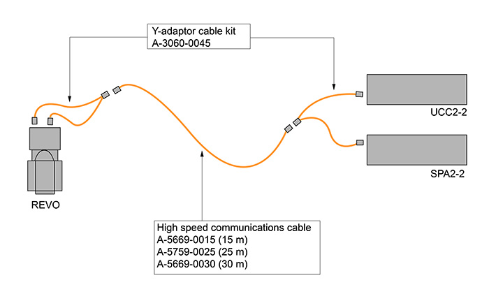

The Y-cable adaptor kit was introduced to enable the use of a single high-speed communications cable with REVO
  • Y-cable adaptor kit componentY-cable adaptor kit componentPreviously it was necessary to install two cables to connect between the REVO head and the UCC2-2 and SPA2-2
  • The Y-cable adaptor kit contains two components (shown below), that connect to each end of the high speed communications cable
Y-cable adaptor kit illustration
High speed communications cable
  • The high speed communications cable provides a single, high quality connection for the purpose of carrying the high data rates required by 5-axis systems
  • To provide greater integrity communications, the maximum recommended cable lengths are:
  • PH20 installations - 25 m
